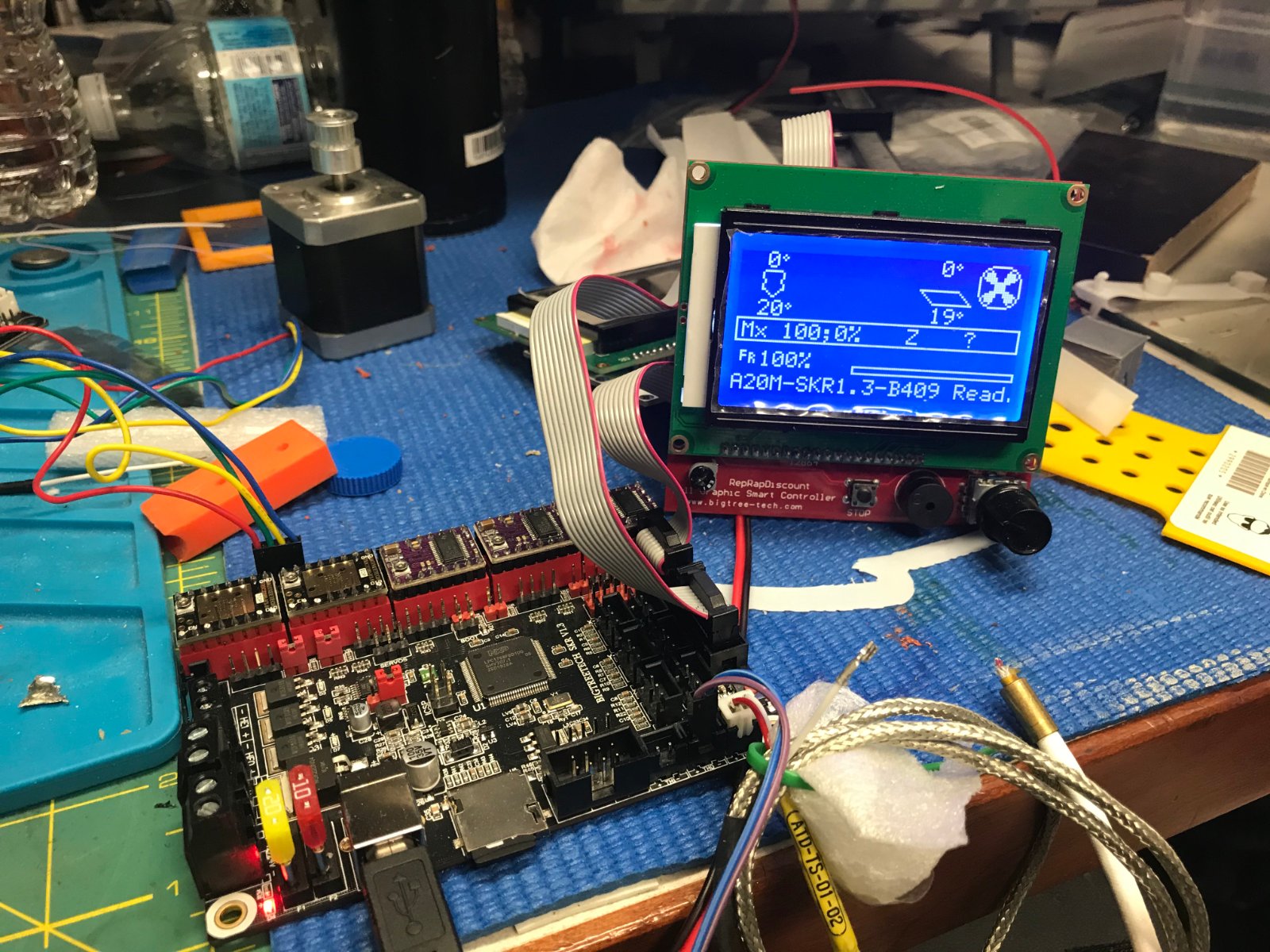

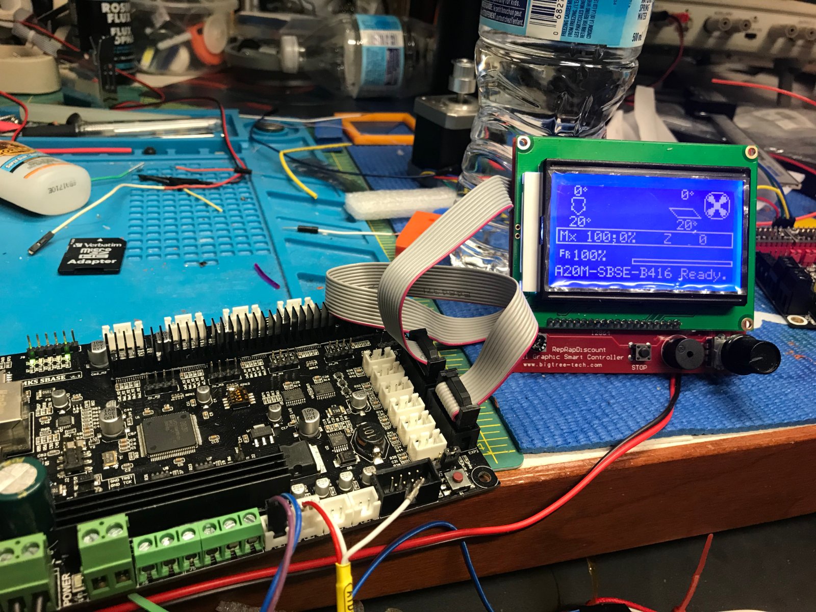

hello fellows A20M /A10M users:
has anyone here gone far enough to start thinking about upgrading their Main Board?
I'm slowly started to gather all needed parts for this project of mine, and wanted to know if anyone has already gone this route....
so far I 've gathered:
skr V1.3 or MKS Sbase with bigtree's TMC2208 V3 or the onboard DRV8825
molex connectors
40pins flat cable breakboard
the main idea here is to build custom cable connection for the E0 and E1 that will brak to different connectors tobe used on the new main board.
since the LCD is "good enough" , and has dedicated SD slot to the frame, it will need the 40 pins flat cable break board to build the Exp1 & Epx2 connection
if you have any experiences and could share in here, or feedbacks... all are very welcome!!!
My skr V1.3 and Sbase has already flashed with Vert's build of Marlin2 and initial testings are all good.
cheers :D ;)

working in progress.....
this part is the easiest one thanks to Vert
