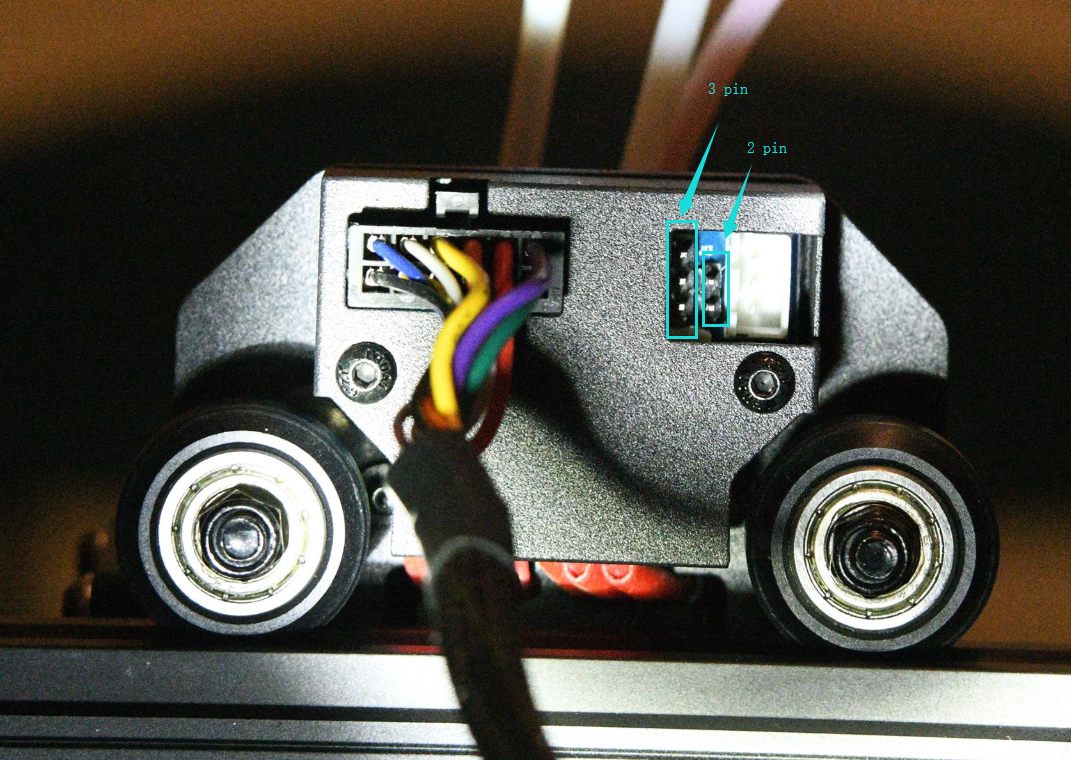

Hi,guys.
something about how to connect the 3d touch in A10T.
you can refer to this:
3d touch 标准图.png (1.44 MiB) Viewed 29623 times

Thanks for the pictures on how to connect. I connected my sensor how you show it; however, it does not home properly. Also I do not see the BLTouch Self-Test option they use in the YouTube video https://www.youtube.com/watch?v=_RtsZDbR2po&t=66s Do I need to update the firmware? If so I could only find the A10M firmware. How can I modify that to work, or where can I find the A10T firmware?

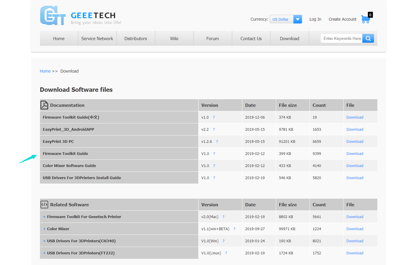

Hi, If you install 3d touch, you need to update the firmware to that with 3d touch.
You can download it here: https://www.geeetech.com/download.html?download_id=49
You can refer to this to update the firmware: https://www.geeetech.com/download.html?download_id=40
