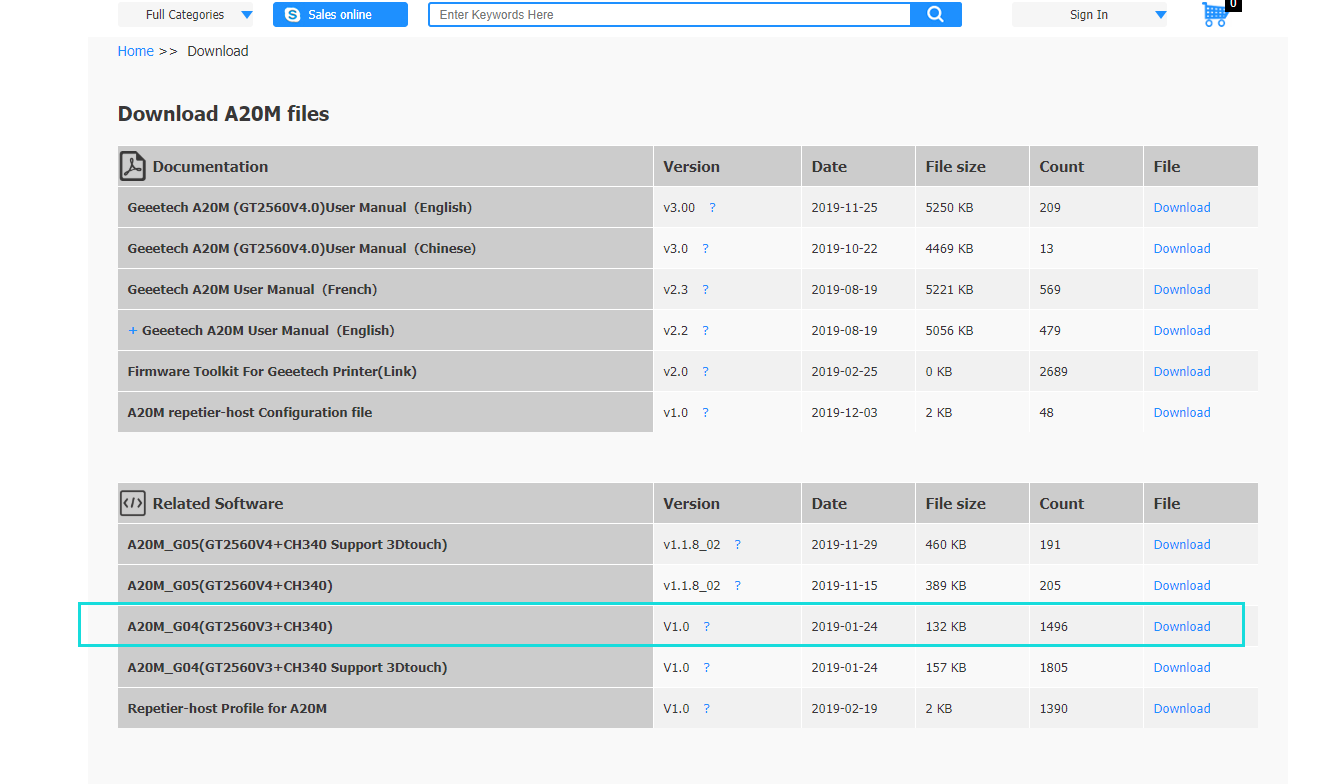

2.Download the hex firmware you need on the official website
PS:(I downloaded A20M)
you can download this link: https://www.geeetech.com/

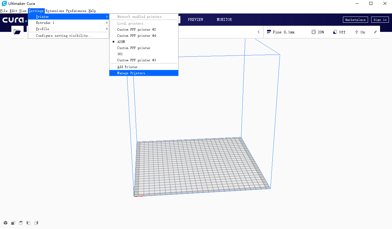

3.choose the settings-printer-manage printer

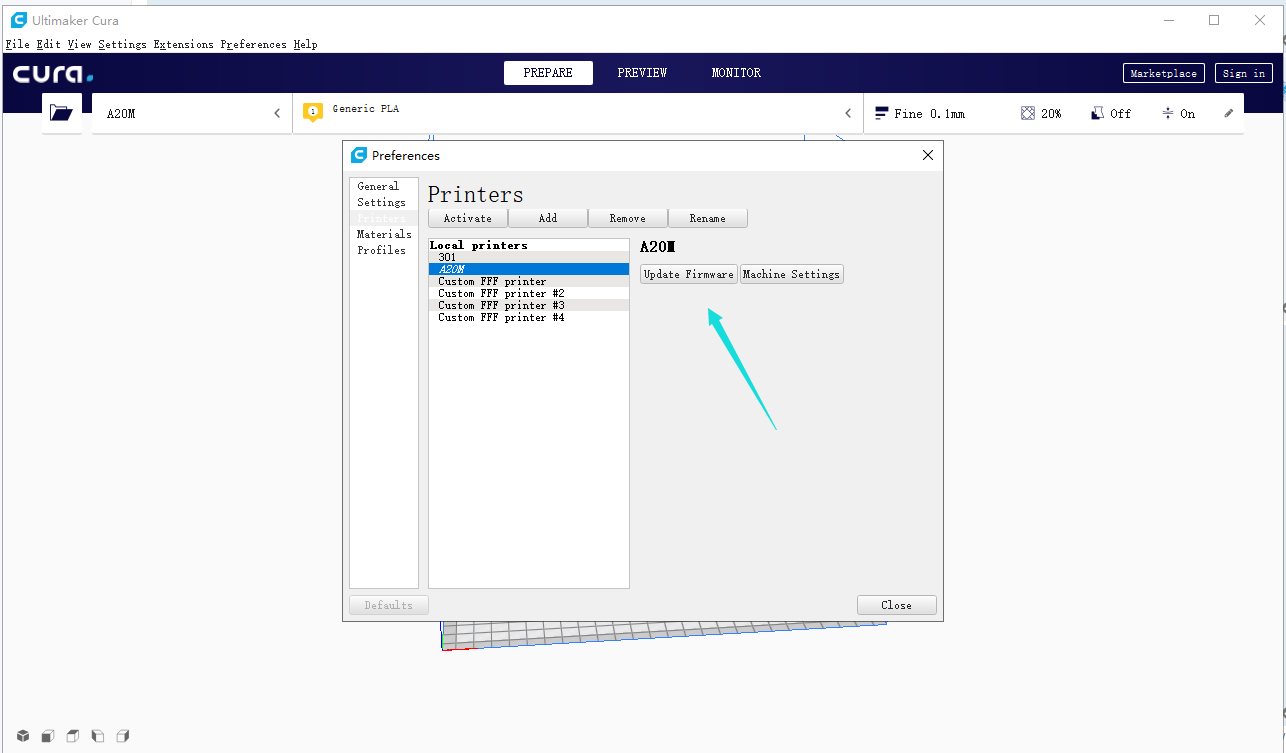

4.choose printer-update firmware
choose you download the hex firmware
5.done
