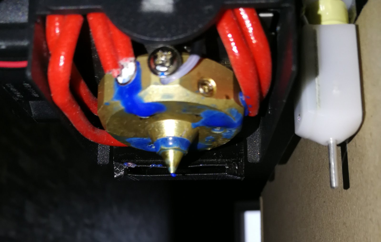

Need some help. Does anyone know how to secure the heating elements properly? The filament is leaking from their placeholders. The printer is Geeetech A20T. Do not mind the nozzle leakage, I have fixed it already.

:D Hi,From your picture, the consumables are leaking from the heating block.
You can check it,
If it is indeed leaked from the heating block, it is caused by a defect in the hot end itself.
You can provide your purchase address, country, your order number, and replace the hot end for you.
