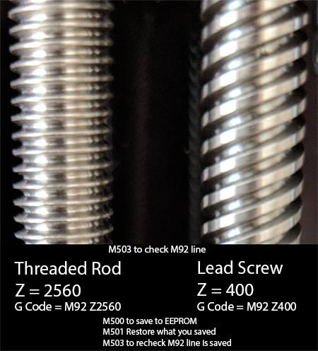

:D Hi,Guys
something about the PRO B z-axis step value
Since the z-axis screw may be different,
The step value in the firmware is 400 by default.
You can modify and save it on the screen according to the situation.

Hey, how can I change my z axis step value in the firmware using the Arduino IDE?
I actually have the opposite problem, where I need to change it from 2560 to 400.
Thanks,
-Tony

If you need the source code, please check the link: https://github.com/Geeetech3D/Prusa_I3_3Dprinter
