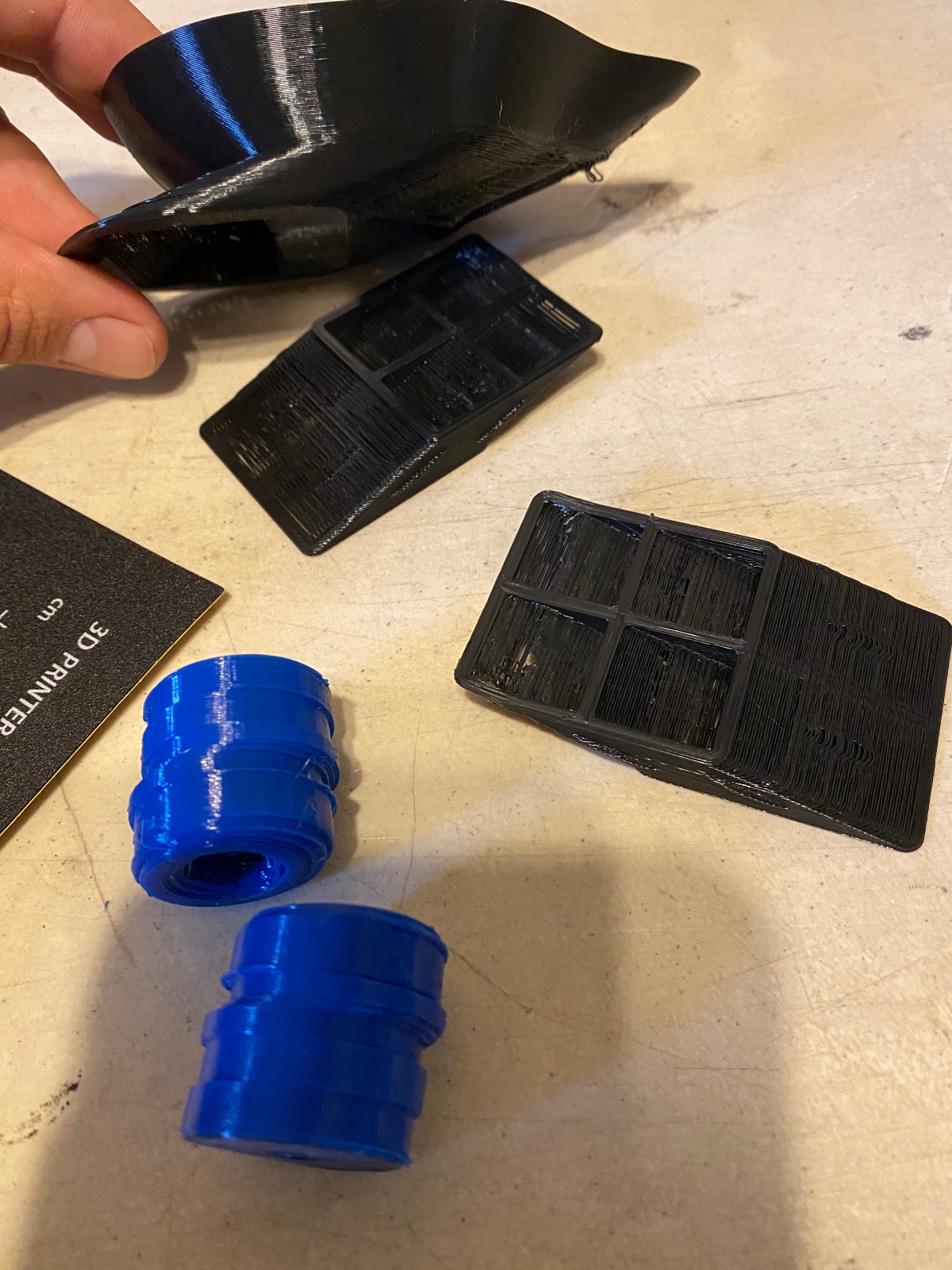

I’m getting problems with layer shifting.
I already tightened the belt.
Up the volts on the driver
Lower the volts on the driver
Lower jerk and acceleration
Tried another slicer program
Not sure what else to do.
- 22E4638C-DD32-48CC-BBD4-7F83D92BE963.jpeg (651.16 KiB) Viewed 26984 times
Re: Layer shifting
The blue ones are with low voltage.
The black ones are with high voltage

i adjusted the voltage to 1.2 and still getting layer shifting.
i was looking at the tmc2208 you sell. it comes with heat sink.
The ones in mine right now dont have heat sink..
where they supposed to come with it ???
maybe they are getting too hot because they dont have heat sink ?

I had the same Y-axis shifting issue. I had lowered my X and Y axis driver voltage because my Y axis driver blew out due to Geeetech not including heatsinks...thanks guys...
I adjusted the voltage back up to 1.25v once I had heatsinks and it solved the problem for me.
