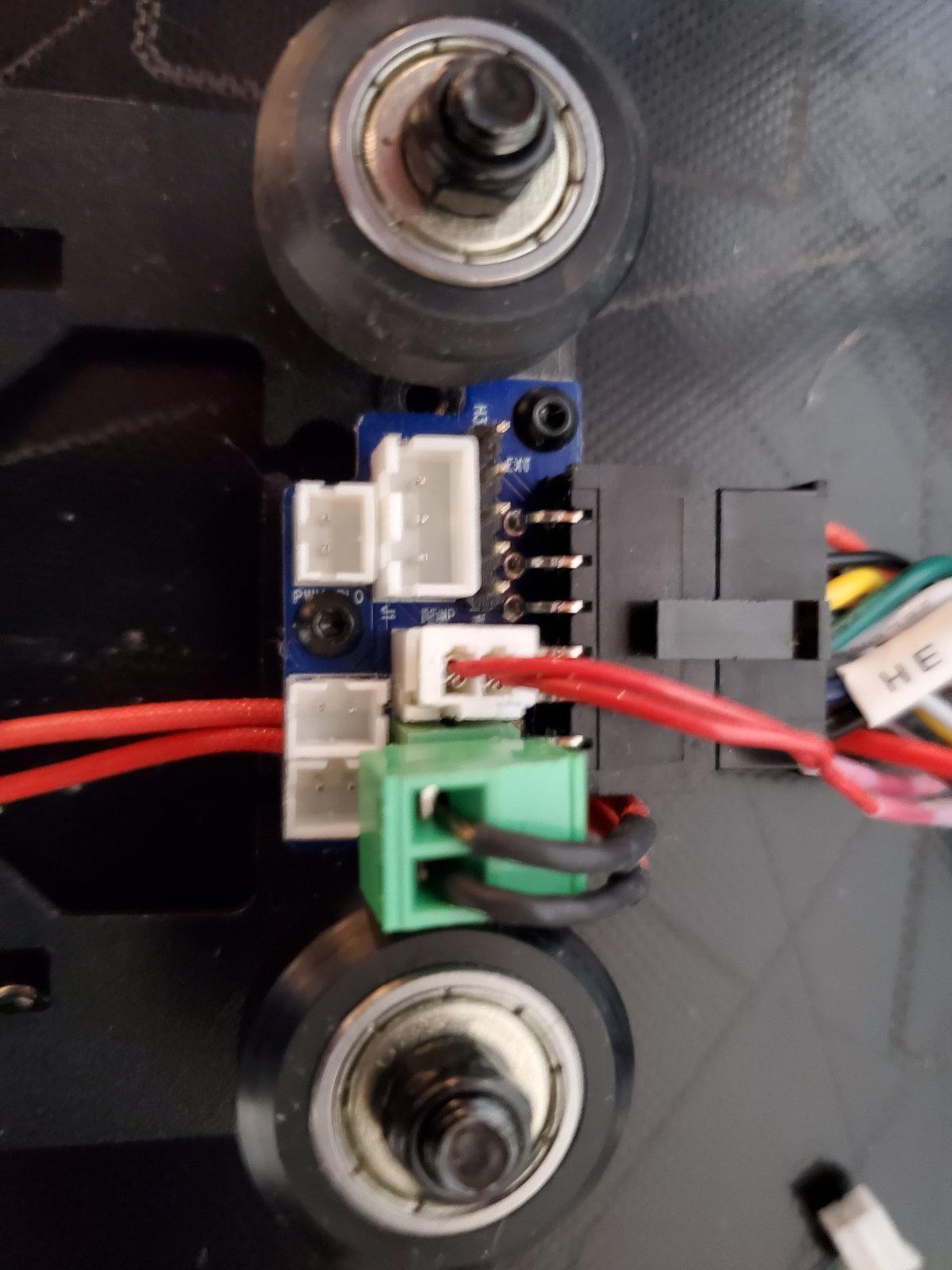

attached below is a pic of my hot end PCB.
What 5 pins do I connect to and what colors go where for the Geeetech 3D touch.
Thanks in advance

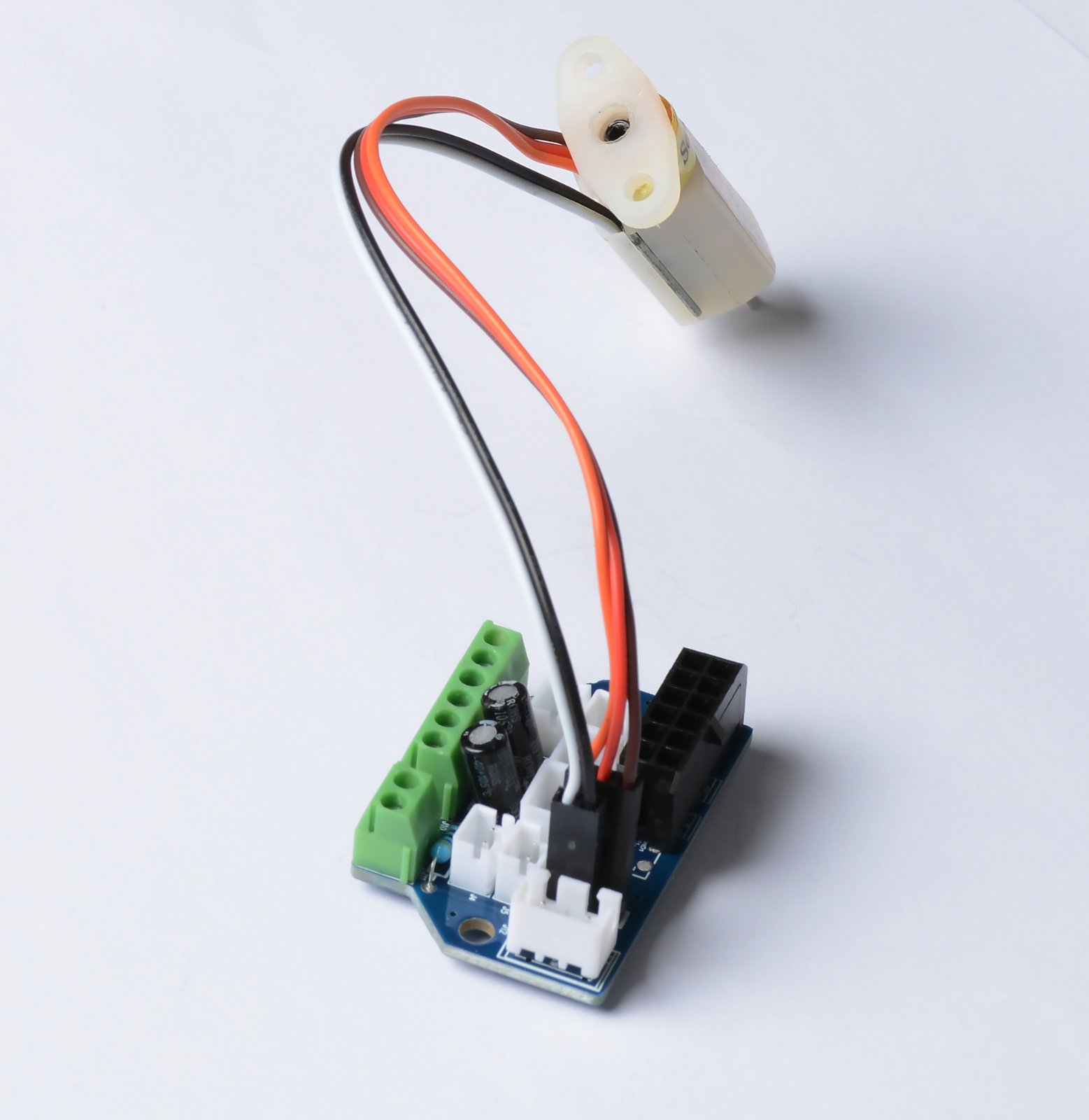

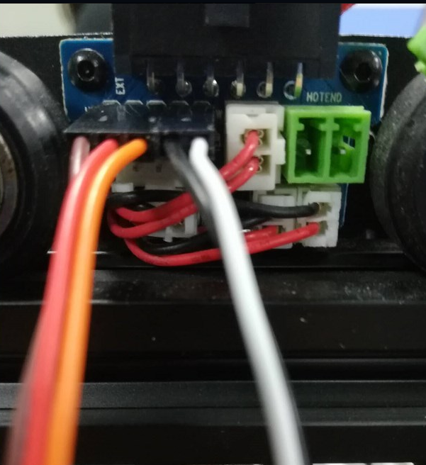

转接板的3d touch接法.JPG (130.74 KiB) Viewed 4077 times

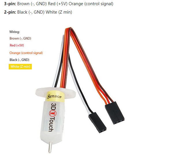

3d touch 接法.png (398.84 KiB) Viewed 4077 times
you can refer to this:
