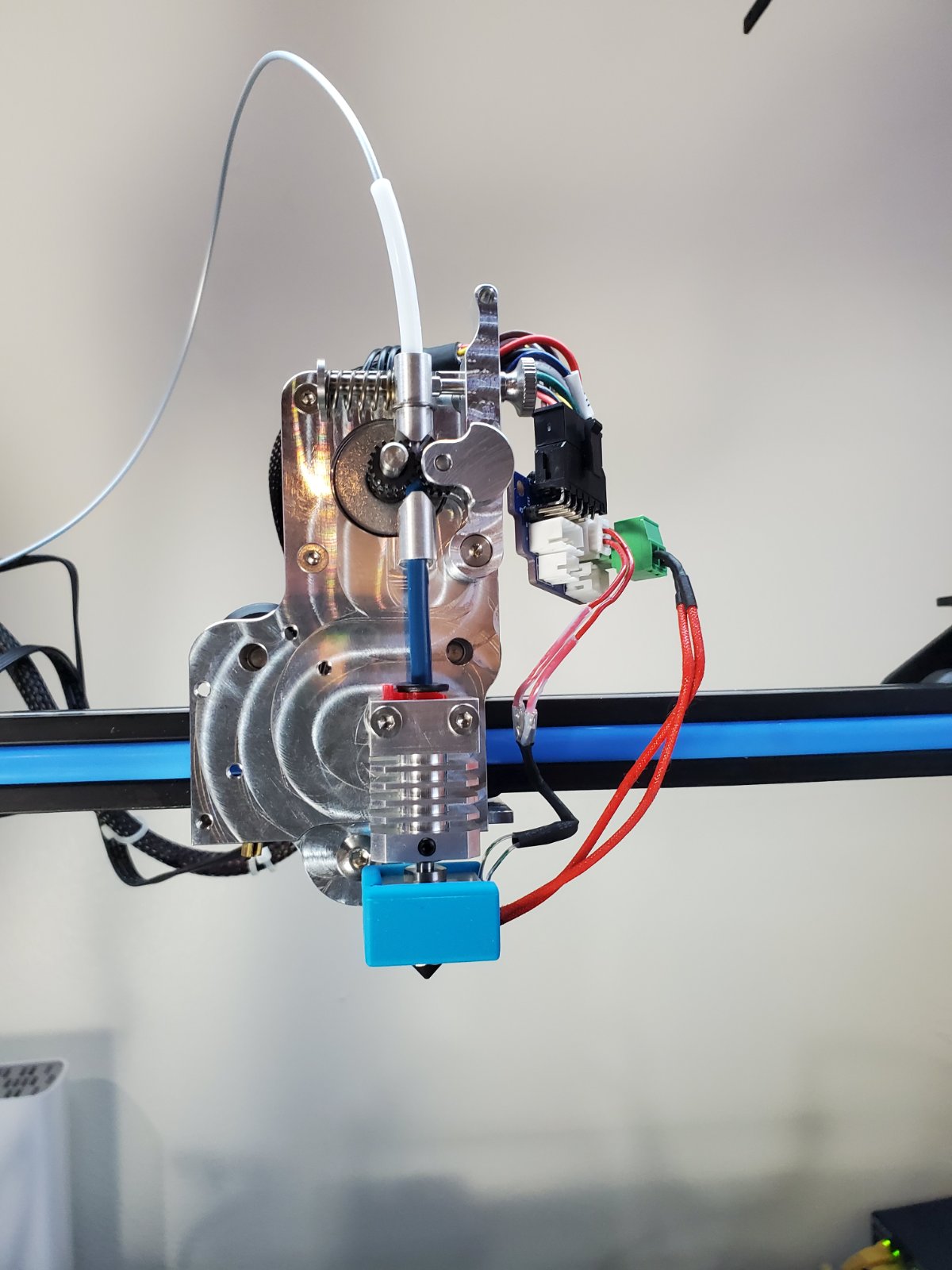

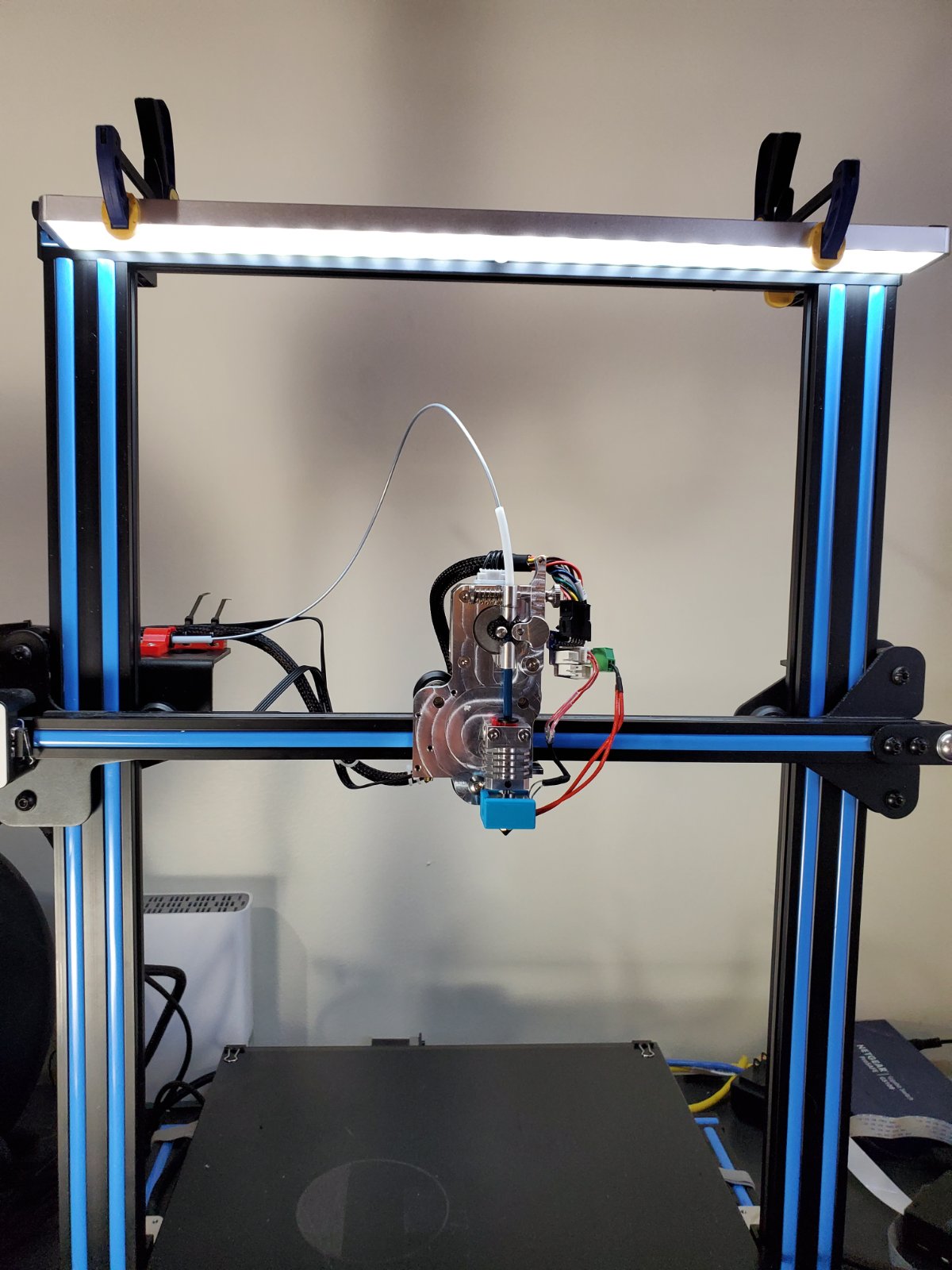

Well the kit came in early.
Shipping was about 2 days.
Here she is naked without any fans or cooling shrouds.

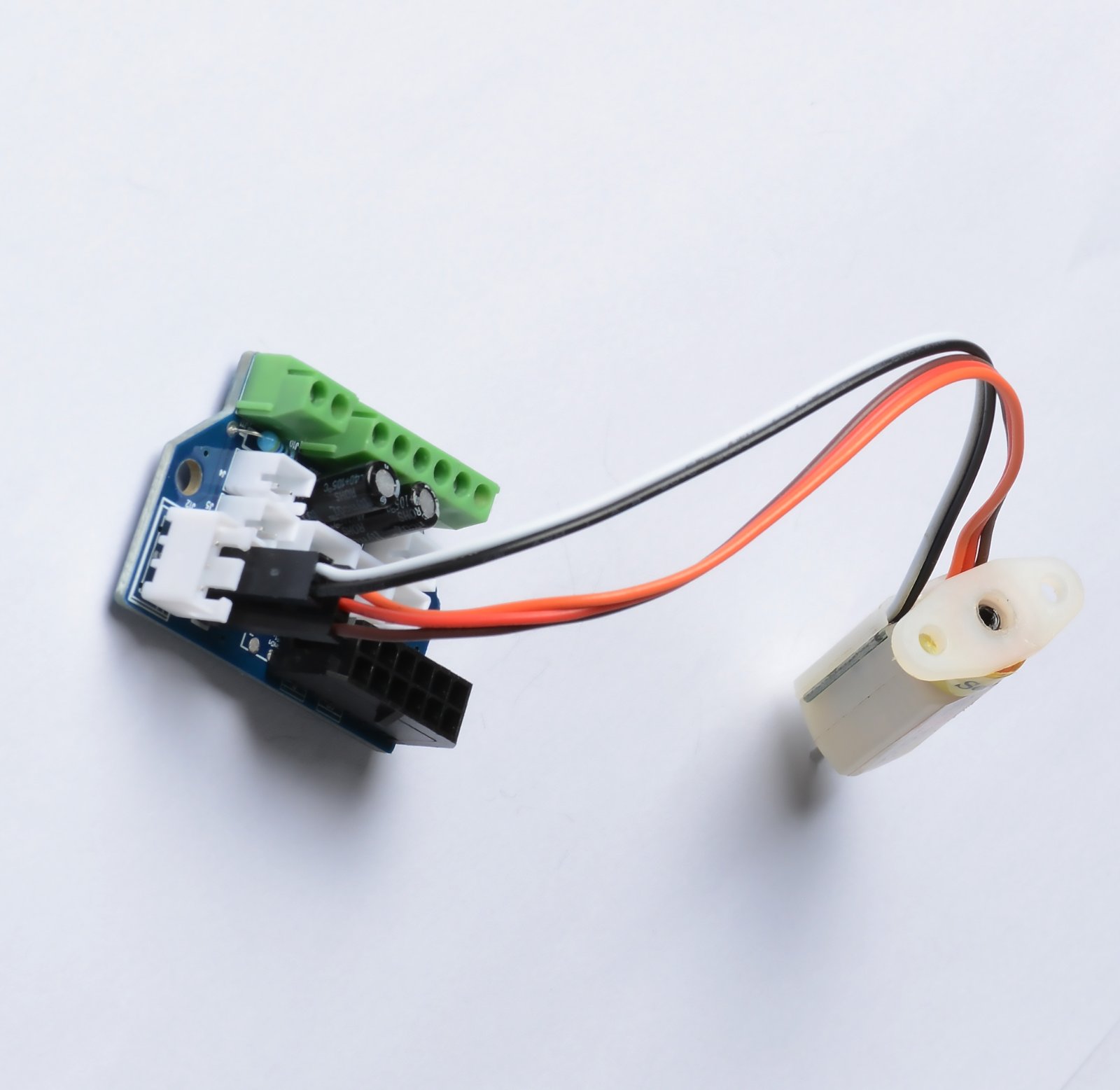

The fans will be coming this weekend and I will need to print a Cooling shroud with a 3d touch adapter. I also have to figure out how to connect the Hot End circuit board.
I won't recommend this kit yet but I was able to get it on my A30 with some modification. The X-axis belt was too tight. I had to reset the clamps on the belt And it was just barely long enough. Had I known I would have purchased a
belt and clamps.

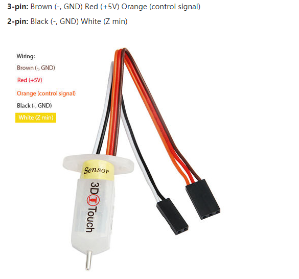

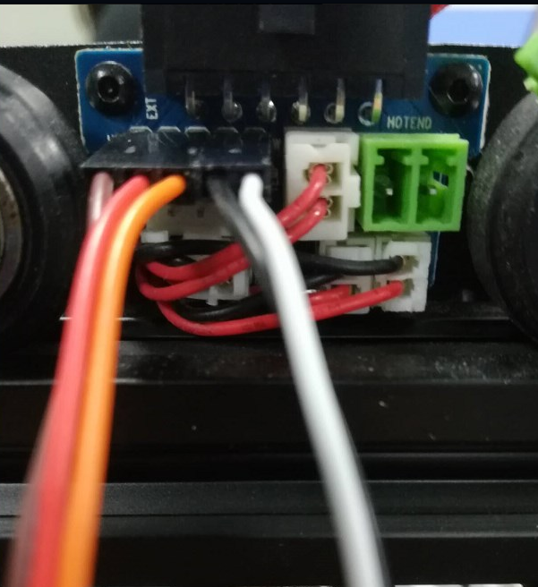

Hi,you can connect as shown:
3d touch 接法.png (398.84 KiB) Viewed 4457 times
