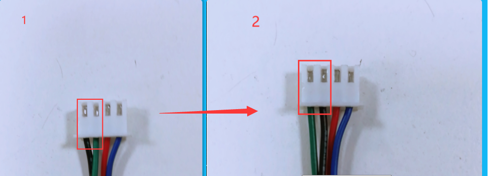

Hi all. So I'm super new to anything other than basic 3d printing and I'd like to upgrade my A20m using tmc2208. Now thats as much as I know. How difficult is it to upgrade? Is it as easy as plig and play? I've heard i would have to switch motor directions which I'm OK with but what else. All help is appreciated

Hi, if you change to TMcc2208, you can directly exchange the line sequence of the motor line, this method is relatively simple.

Is this the only thing I will need to do? Are the drivers plug and play otherwise?
