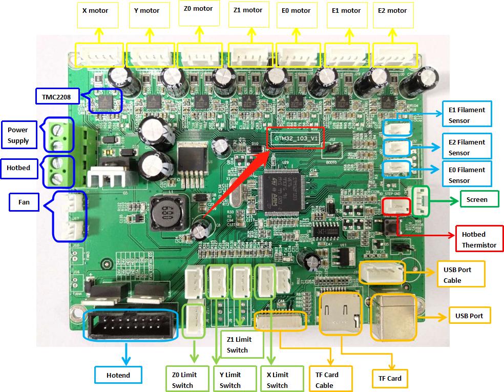

Got it, opening the printer will help to understand :D. My printer has the MB11 (GTM32_103_V1):
What I mean is to use the buck converter, solder an old fan cable to its input and connect it to a spare fan connector on the printer's mainboard. My board has two of it (on the left), one is occupied by the case fan, one is free. The printer mainboard contains a USB-B port you can use for connection to the RPi after you removed the USB-interconnection cable from the extension port. So can place the RPi inside the casing.

Ohhh that's what I was hoping but I am curious of the specs of those 2pin fan headers. I feel like Geeetech should have that info but I feel like it would be hard to get the answer. Cuz a 40mm fan might be something like 0.06amps, but the Pi might be about 1amp, so idk if that would be a good idea for those fan headers. Unless the buck converter makes that safe? Sorry I am not terrible with electronic stuff, but its been about 12 years since I was in school and had a class on them. I like the idea of the USB port on the inside though, I didn't know it had one of those ports. I really need to open my printer up but I keep putting it off until I measure it for an enclosure since I wanna use ABS

MOCCOR wrote: Sat Mar 20, 2021 5:01 am Ohhh that's what I was hoping but I am curious of the specs of those 2pin fan headers. I feel like Geeetech should have that info but I feel like it would be hard to get the answer. Cuz a 40mm fan might be something like 0.06amps, but the Pi might be about 1amp, so idk if that would be a good idea for those fan headers. Unless the buck converter makes that safe?
