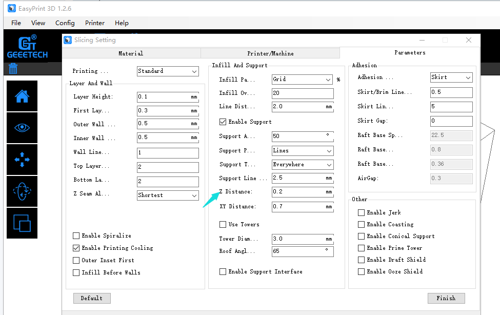

OH, you can observe the distance transform I set
0.2mm
2mm
However, we set up support to ensure that the suspended parts do not fall. So can't be set too big.

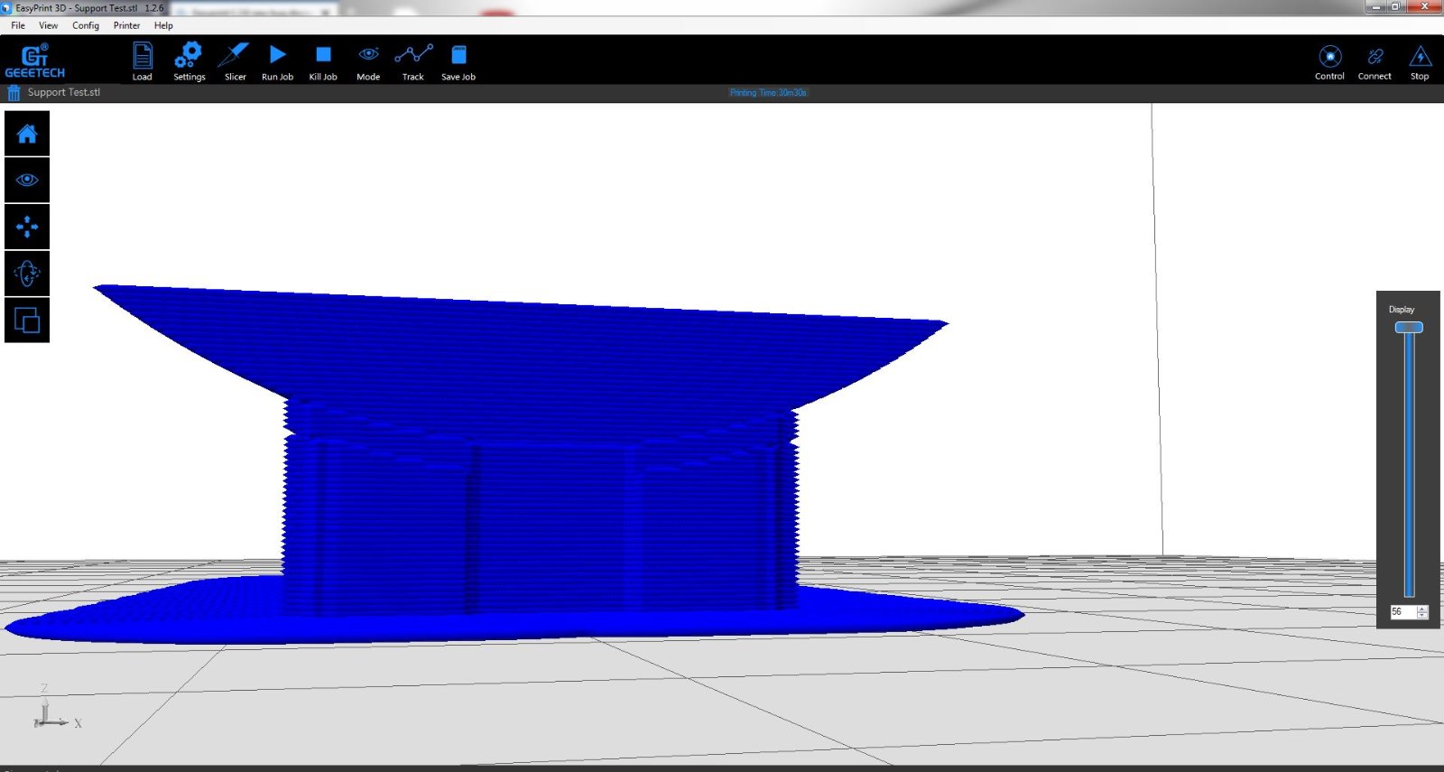

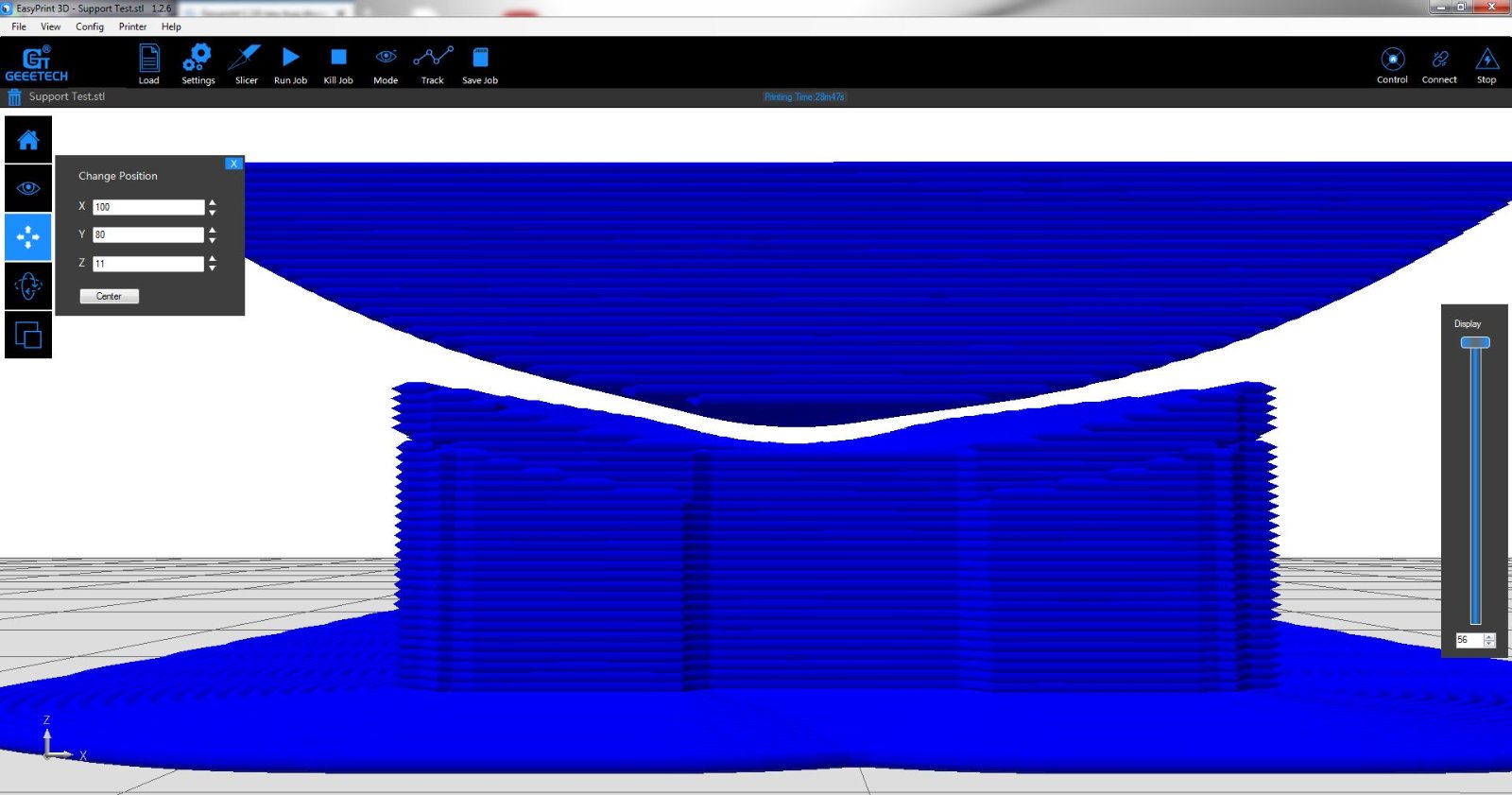

Yes, you can set the value but it does not have any effect on the model. I also enabled support interface. I don´t know if this has any influence on it. I took a few screenshots.
Here I set the Z-distance to 1 mm. The gap is clearly visible:
Z distance 1 mm.JPG (157.43 KiB) Viewed 22444 times
Here I set the Z-distance to 0,9 mm. There should not be a large difference visible but for every value <1 mm the gap seems to be non existent.

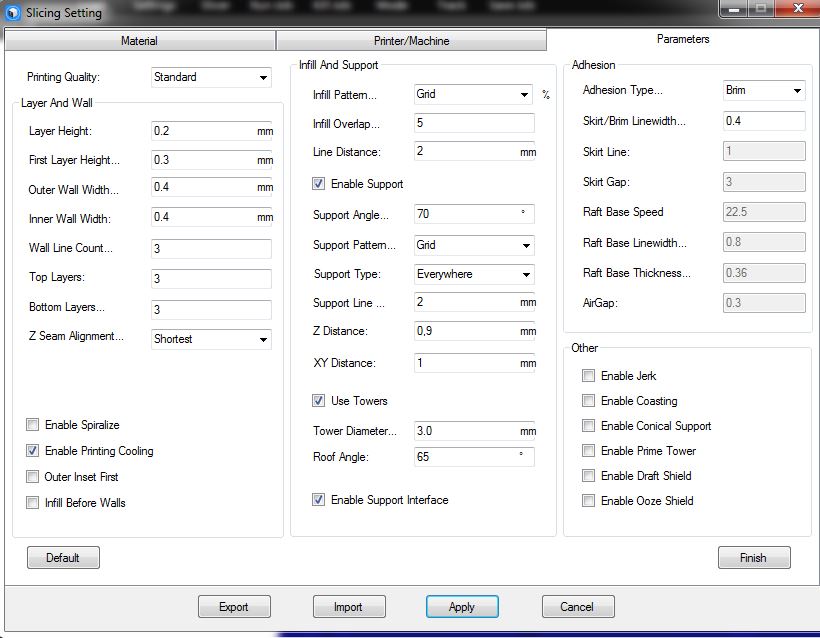

And the slicer settings:
Slicer Settings.JPG (86.12 KiB) Viewed 22444 times
