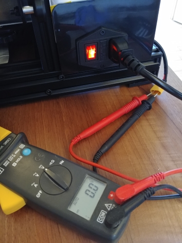

Re: A10 suddently died during printing
Hi, You can measure the output voltage of the plug that is plugged into the motherboard.
If it is still 0v, you need to replace the power supply.
I hope this can help you.
Post by david-77 »
Thank you William, I'll try this tomorrow.

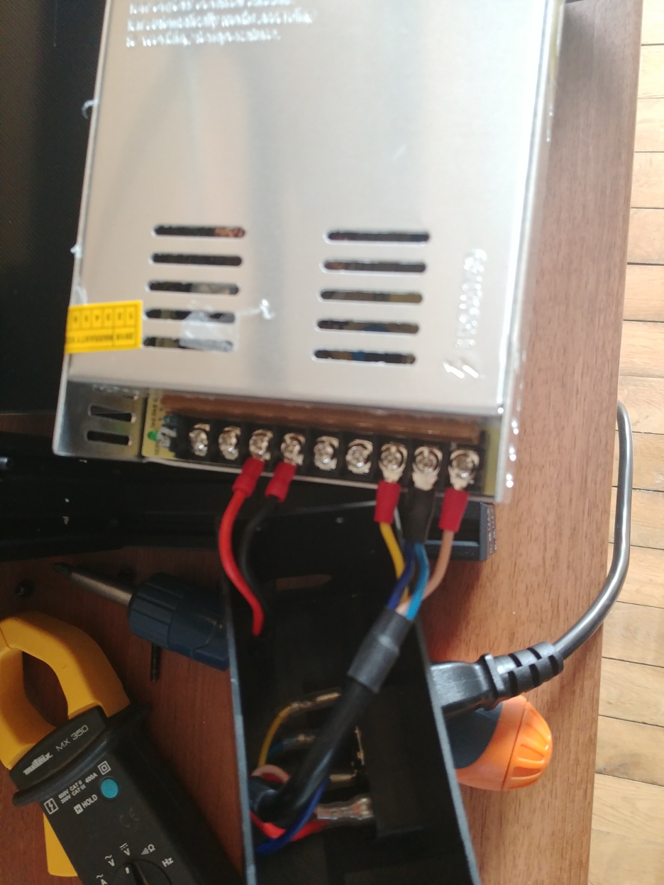

Hi everyone,
So I tried and still get 0v output.
I decided to unmount the PSU, and I checked my input (240v here in France), and 0v output :
I have contacted the reseller, he should send me a new psu.
Thanks everyone for your help !
