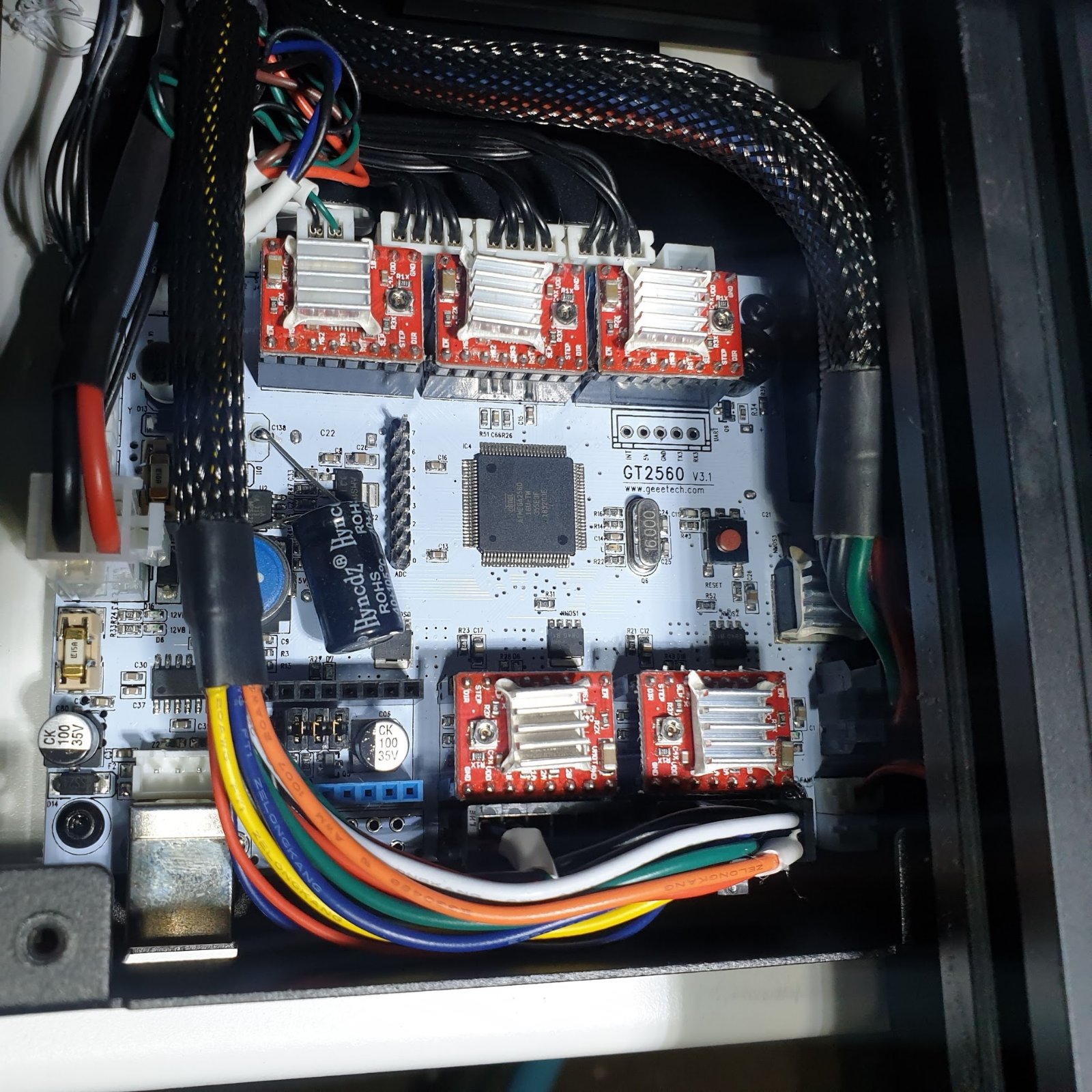

Also, what should I do if I do have the a4988 (which I suspect I might):
M10A board.jpg (447.95 KiB) Viewed 6538 times

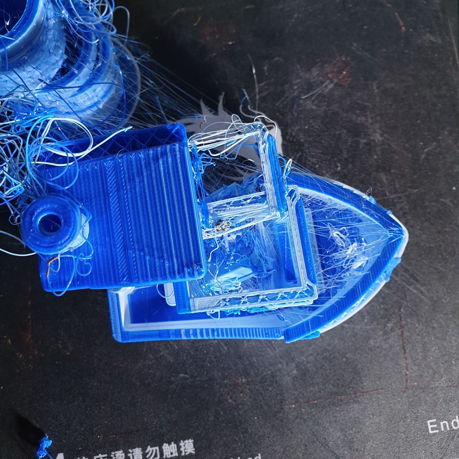

Here an photo of my latest print:

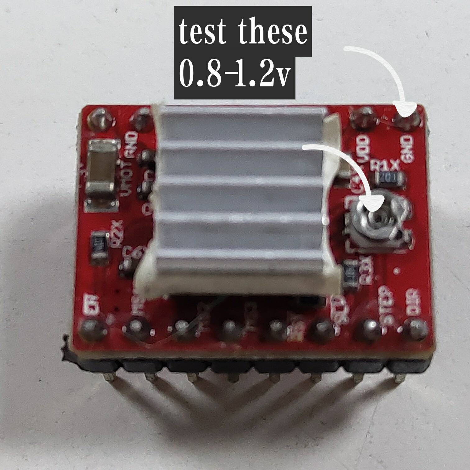

If you need to adjust the driver board voltage, you can refer to this to make adjustments.
A4988 测量位置.jpg (192.77 KiB) Viewed 6534 times
Reference range 0.8-1.2V.

Yes, I am aware of this. What I am wanting to know is what is meant by:
the stock firmware uses 80.3 and 80.8 steps on xy any not whole number is subject to the rounding error where over time of the print you get +-1 step resulting in holes and bumps that could give a shift.
And also how does one check if they have a "a4988" driver and what to do if I do have one.
Thanks.
