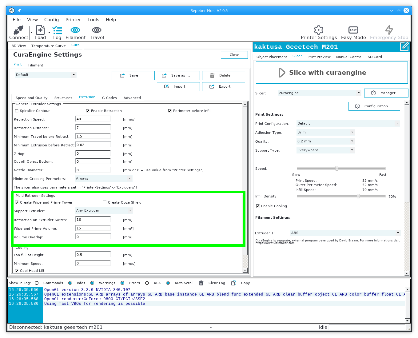

Coming back to printing with different materials I can recommend you to test some options in slicer. See image:
This will help you to solve the problem of retraction. In my example, the options are default.
