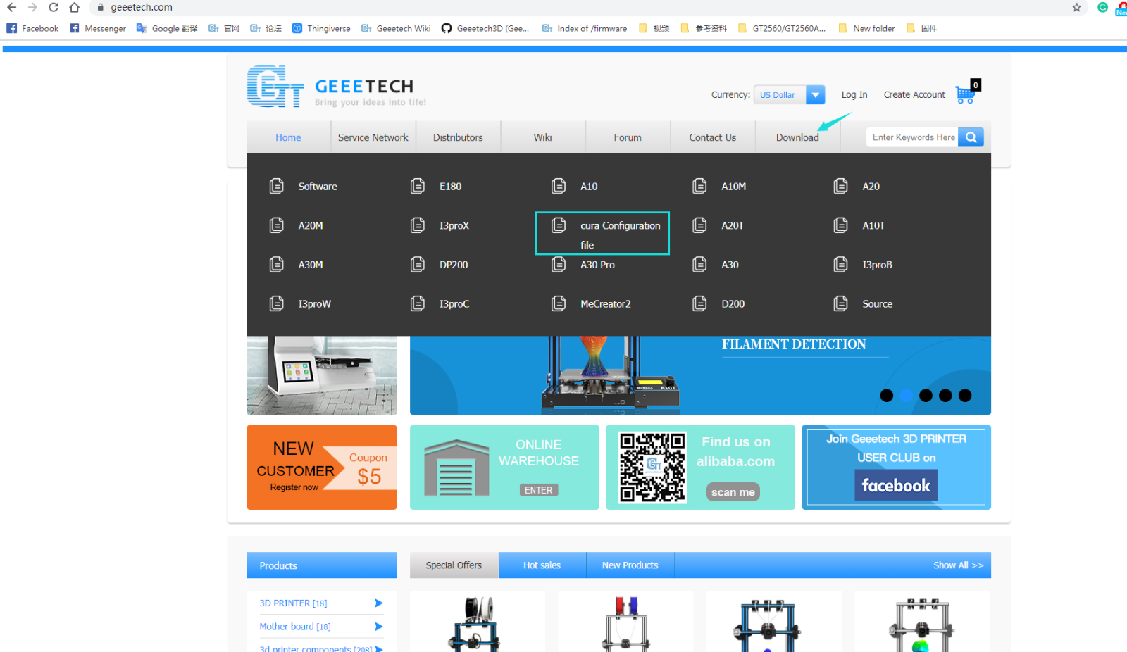

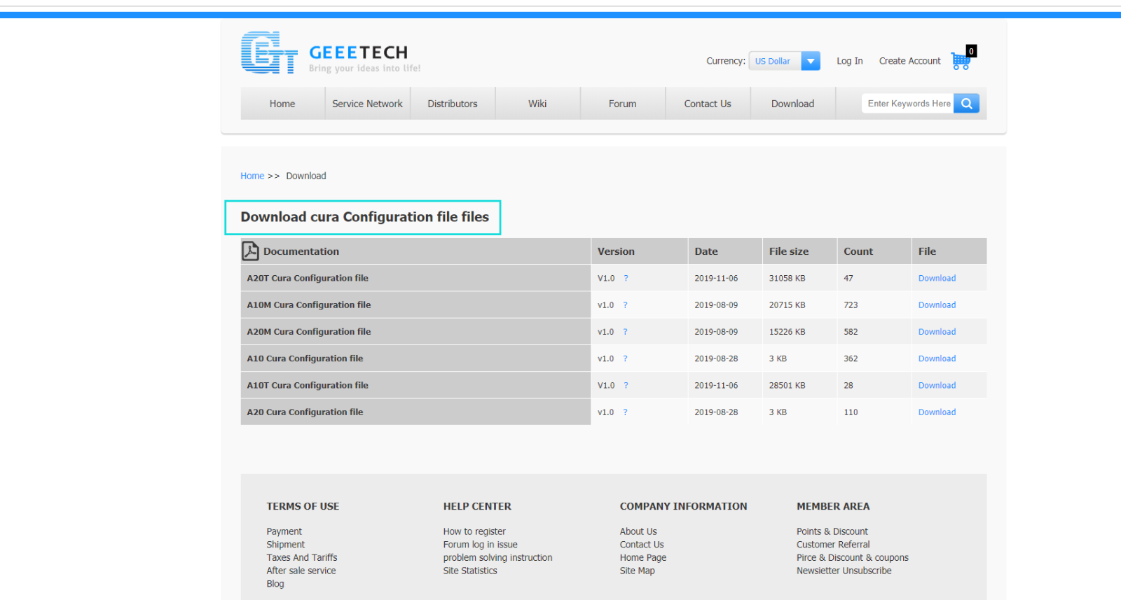

1.you can download in this link:https://www.geeetech.com/download.html?download_id=47
and refer to this

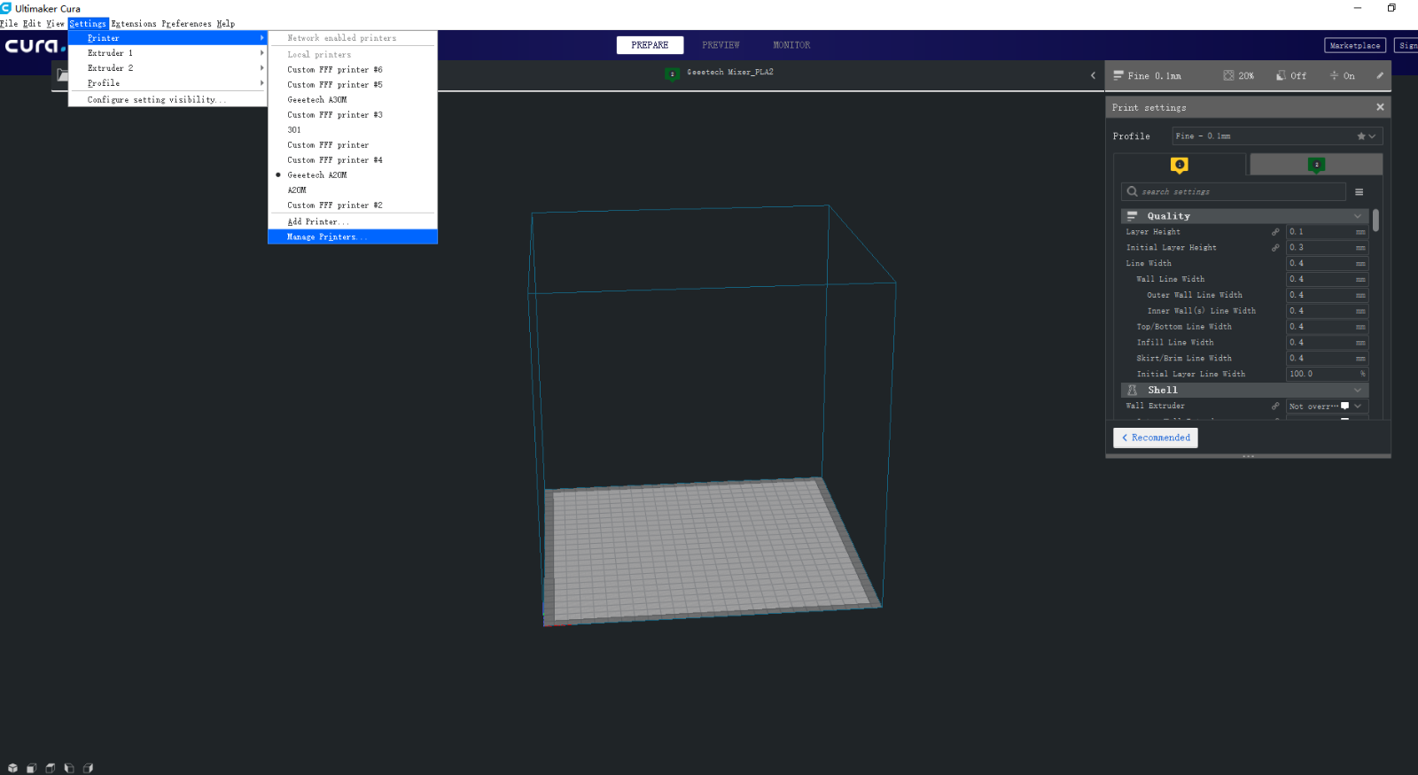

2.you can open the Cura,and choose the settings- printer-manger printer

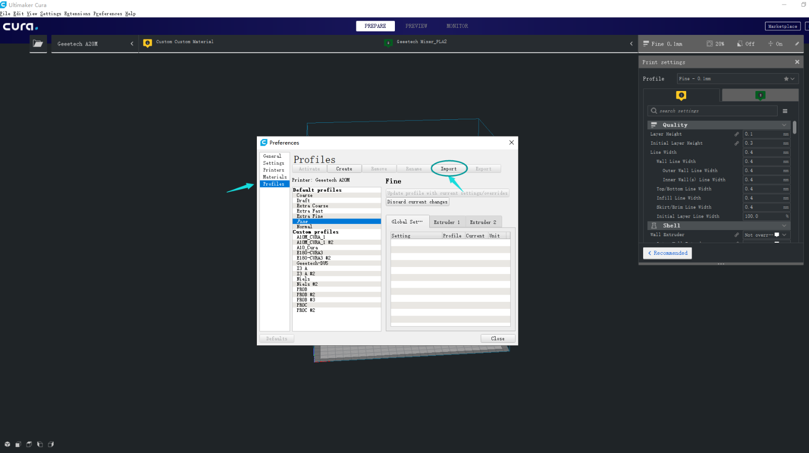

3.and choose the profiles-import

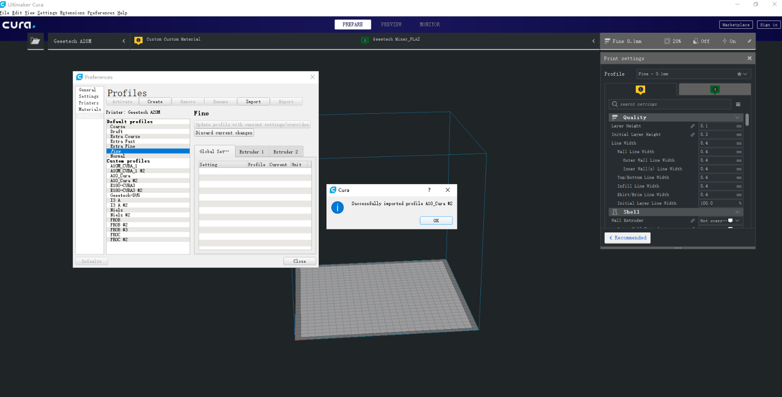

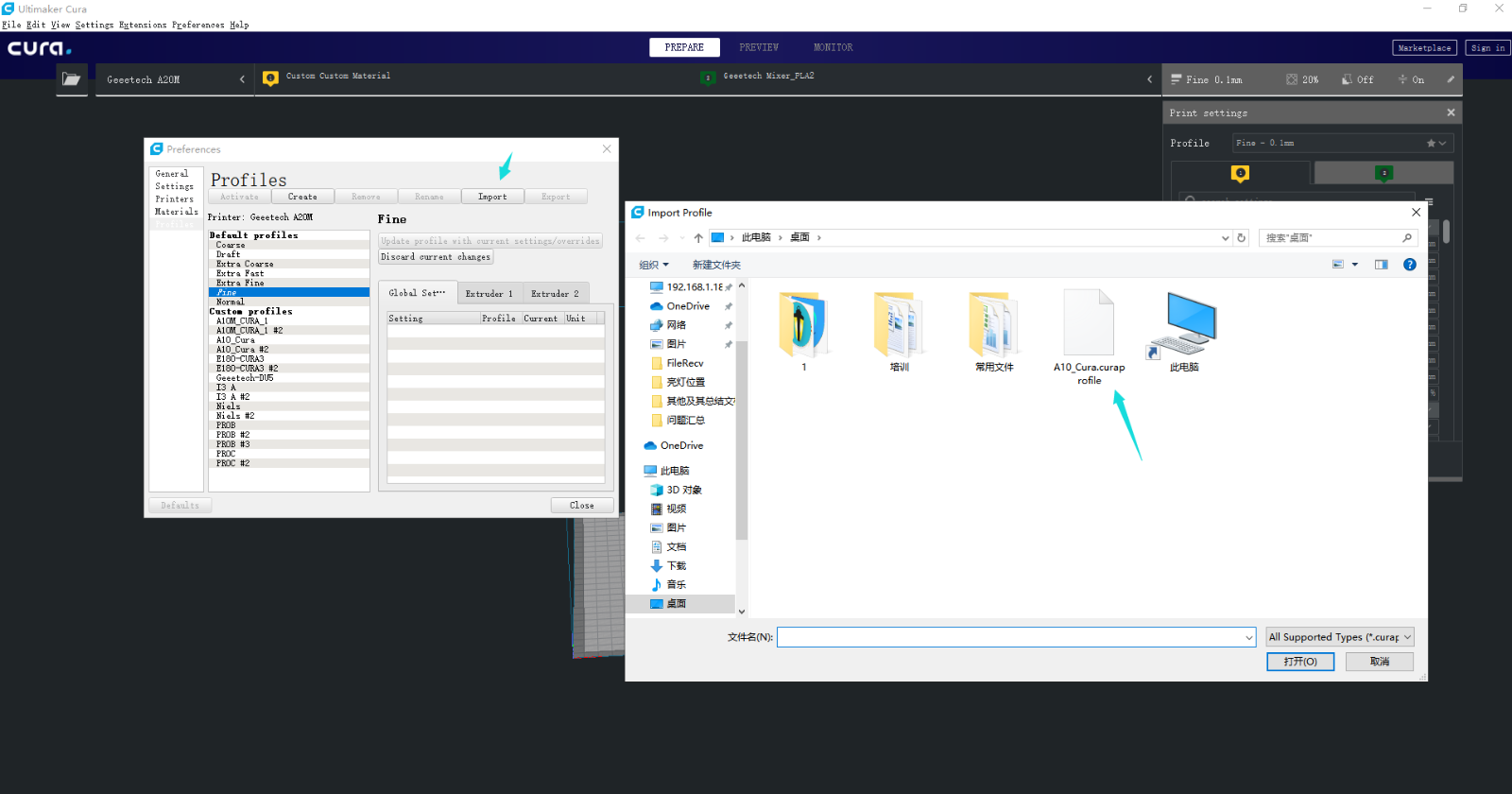

4.choose the profile you need(for example ,I download A10 Cura profile
6.Done!
