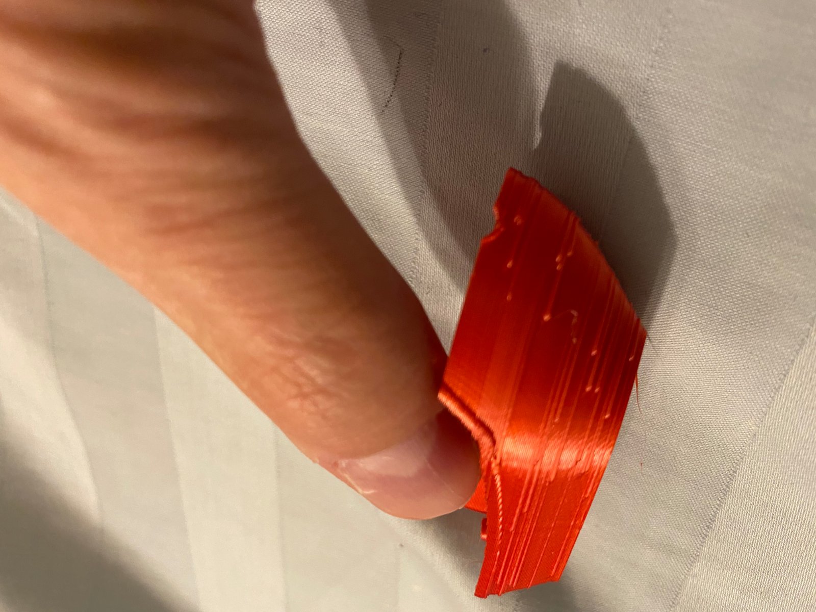

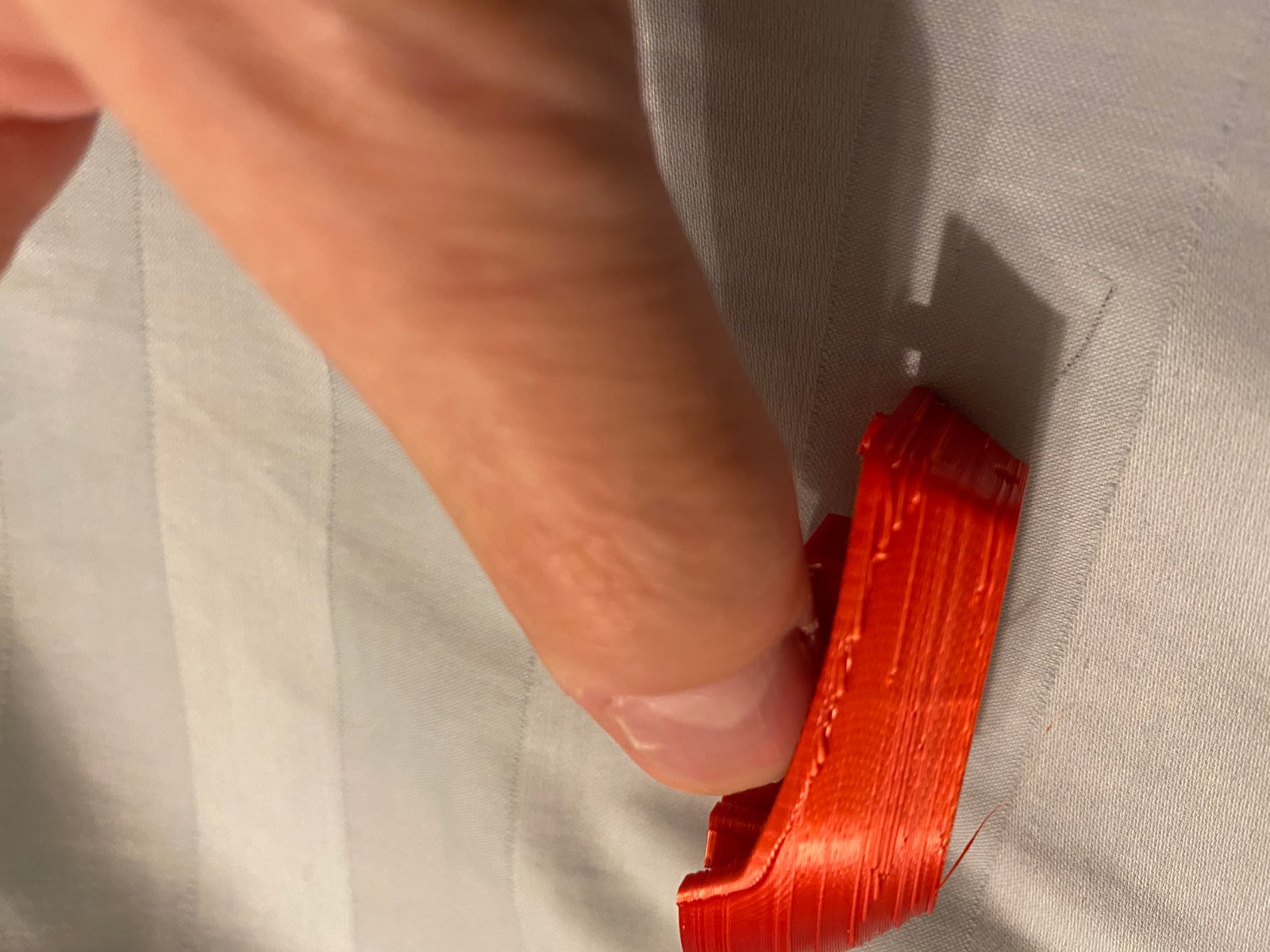

Hey everyone,
Does any one have any suggestions on how i could fix the lines appearing in my prints?
Below is my slic3r profile. I would greatly appreciate any suggestions. Thanks!

Re: Lines in prints
:D Hi, You can try to turn off the z-hop, and then check your mechanism for loose parts,
Tighten it if it is loose.
