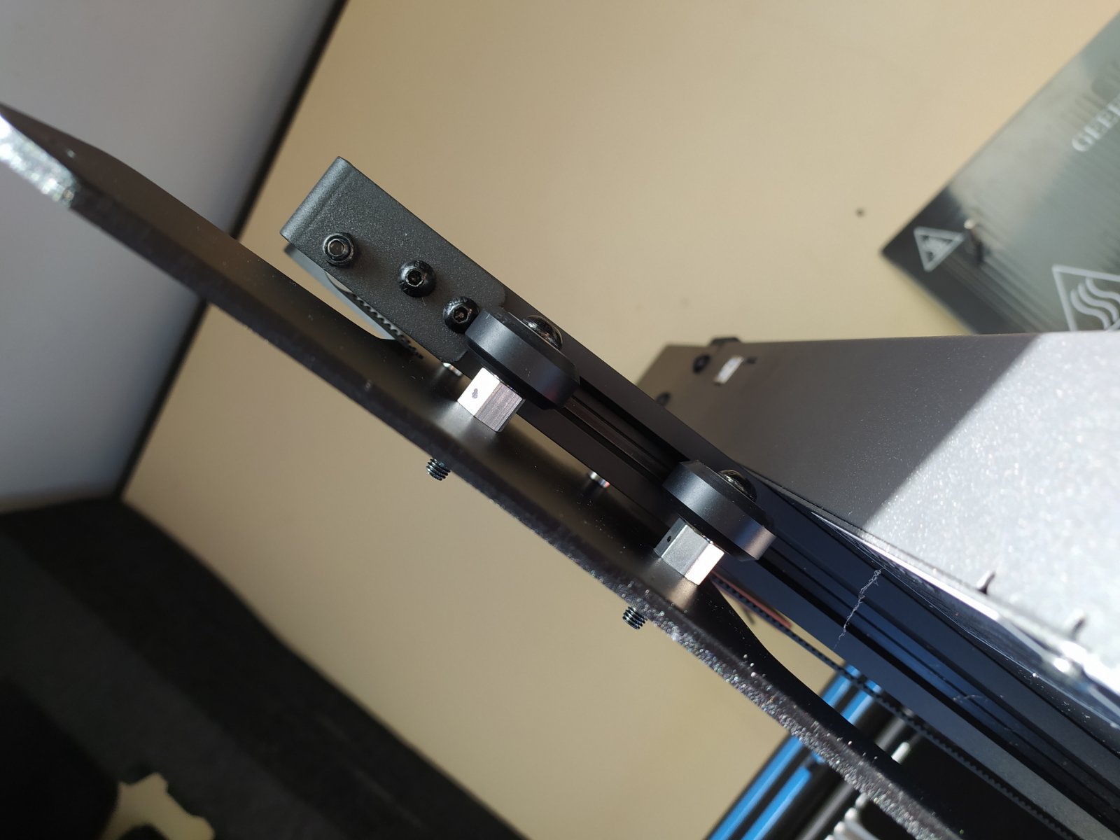

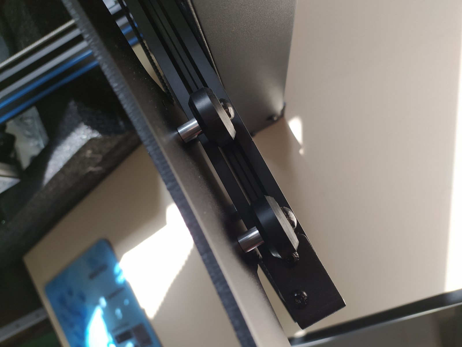

There is an unstable situation : with the hotbed installed, the tiniest slightest pressure on any corner of the bed will make the bed's angle change (the springs don't ever a chance to correct this because the bed's support is so unstable). Also, is it normal that the struts for the wheels are of different kinds for both sides of the bed's support (pictures attached).

Re: Unstable bed, is it normal ?
Hi, is there no corresponding part at your end?
If so, you need to install both sides.
Well, here is the solution :
- The nuts that hold the bed are different because the ones that have an hexagonal shape are eccentric ;
- So, you just need to use a U-shaped wrench to rotate the hexagon-shaped eccentric nuts to adjust the distance between the wheels and the plate support on one side.
