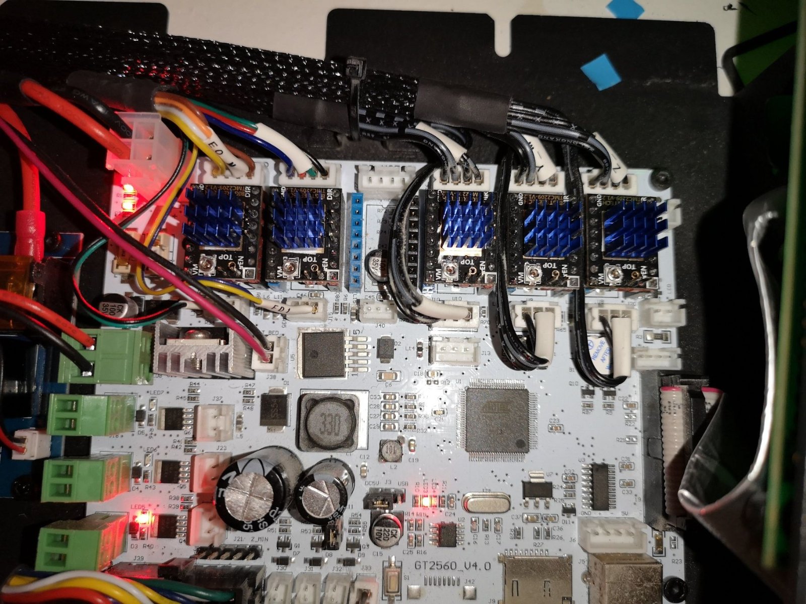

So I'll just share what I've done after purchasing TMC2209 v1.2 from AliExpress - https://www.aliexpress.com/item/33025652788.html . I have A10M printer with GT2560 v4.0 board.
Basically, this was a straightforward replace for all five drivers. First I've measured reference voltage on existing drivers - it was 0.9 for axes and 1.05 for extruders. As recommended in other manuals, I've disconnected all steppers, replaced the drivers paying attention to the orientation - one or the corner pins in the new driver is marked as GND, so I matched it with the GND corner pin on the old driver.
Note, I didn't have to bend or remove any pins as shown in the video referred by the OP.
Here is how they look when installed
Next, I've powered on the printer (steppers still disconnected) and adjusted the ref voltages to about the same values as the old drivers. Clockwise reduces the voltage, anti-clockwise increases. Powered down everything, re-connected the steppers and checked that they all move - I had to heat the hotend to check the extruders. Of course, they were moving to the wrong direction, but I expected this.
Finally, I've opened Vert's Marlin (https://github.com/Vertabreak/Marlin), and in Start_here.h file uncommented the line that says
Code: Select all
#define TMC2209S   // Enable TMC2209 Standalone all drivers
, compiled and flashed it. Actually I would recommend getting familiar with this process before changing the drivers. It's not that hard and a very detailed instruction is in this video - https://www.youtube.com/watch?v=e1tps-5hxgU (of course, you'll better use the latest version of the firmware rather than the one mentioned in the video).
Now everything works fine, I've printed benchy - drivers and steppers temperature was fine. And indeed, the movement is now very quiet. I just need to do something with the loud hotend fans :) (UPD: I've dealt with the hotend too - see here)
I hope this helps someone.

Thanks for your detailed description. Did you remove the jumpers under the steppers as well?
astax
Posts: 3
Joined: Tue Mar 17, 2020 5:13 am
Re: TMC2209 Physical Install and Marlin
Post by astax »
There are no jumpers on this board. Or I didn't find them :)
Anyway, I didn't change any jumpers - just a straight drivers replace.
