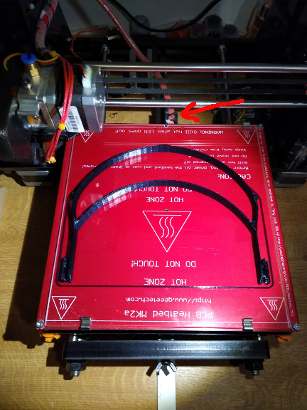

During the coronavirus lockdown I've been trying to print off frames for face shields, The print isn't too complicated but it has a foot print which takes up most of the hot bed. (See below) I had to modify the .stl file to have the initial pre-print brim moved to 2mm from the print rather than 9mm as the filament was dribbling over the edge of the glass plate!
Way back I made a cable strain clamp to prevent flexing of the Y Axis cabling (red arrow) but with the bed to the rear the cabling's been a bit tight. Most of my prints during the past couple of years have had a lot smaller footprints so it hasn't been a problem. I now need to strip the cabling out, find and repair the break and hopefully free off some spare cable length from the circuit board to relieve the strain. Then, with a bit of luck, we should be back in business!
