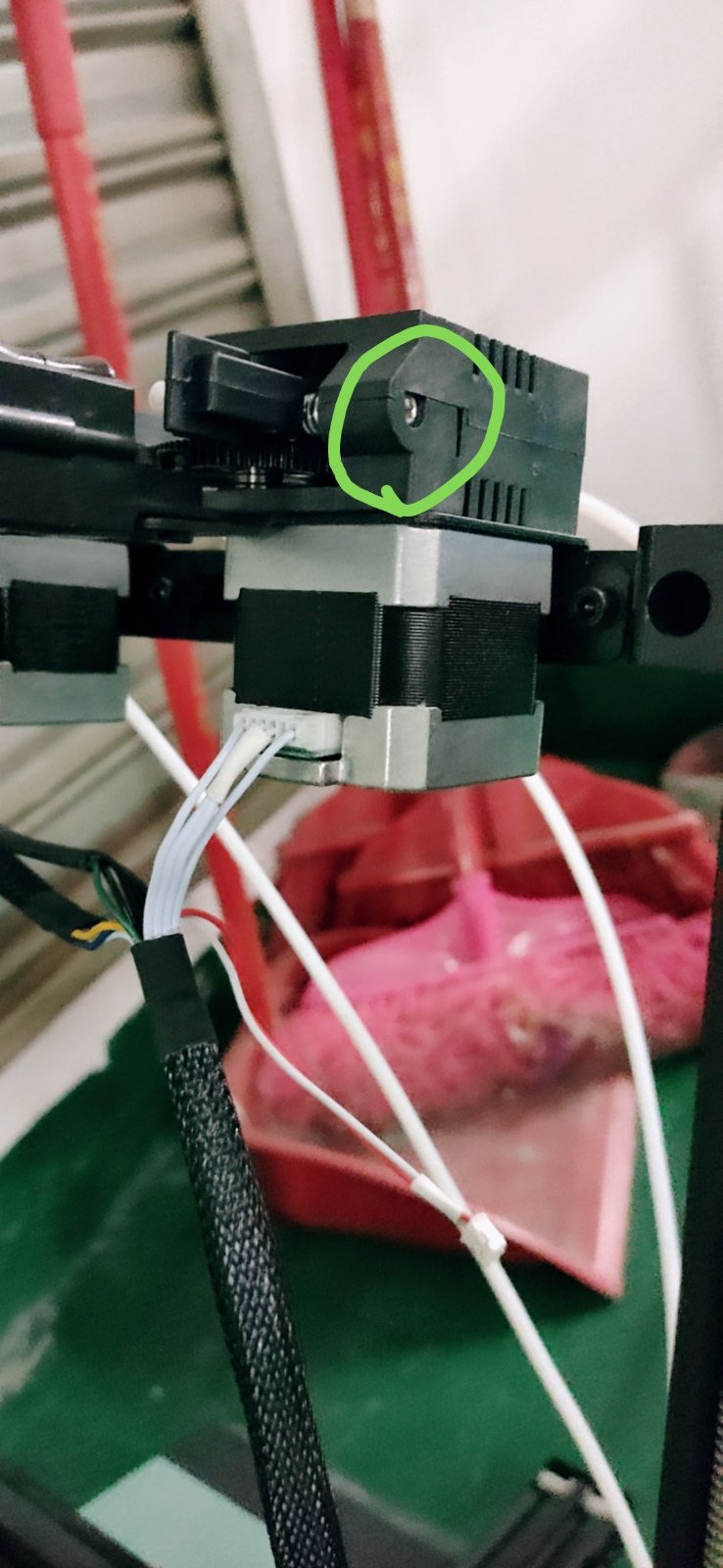

Hi, my friend.
I think it may be that the feeder screw on the motor is too tight to feed normally, you can adjust it.
You can also provide pictures or videos, I will better judge for you.
