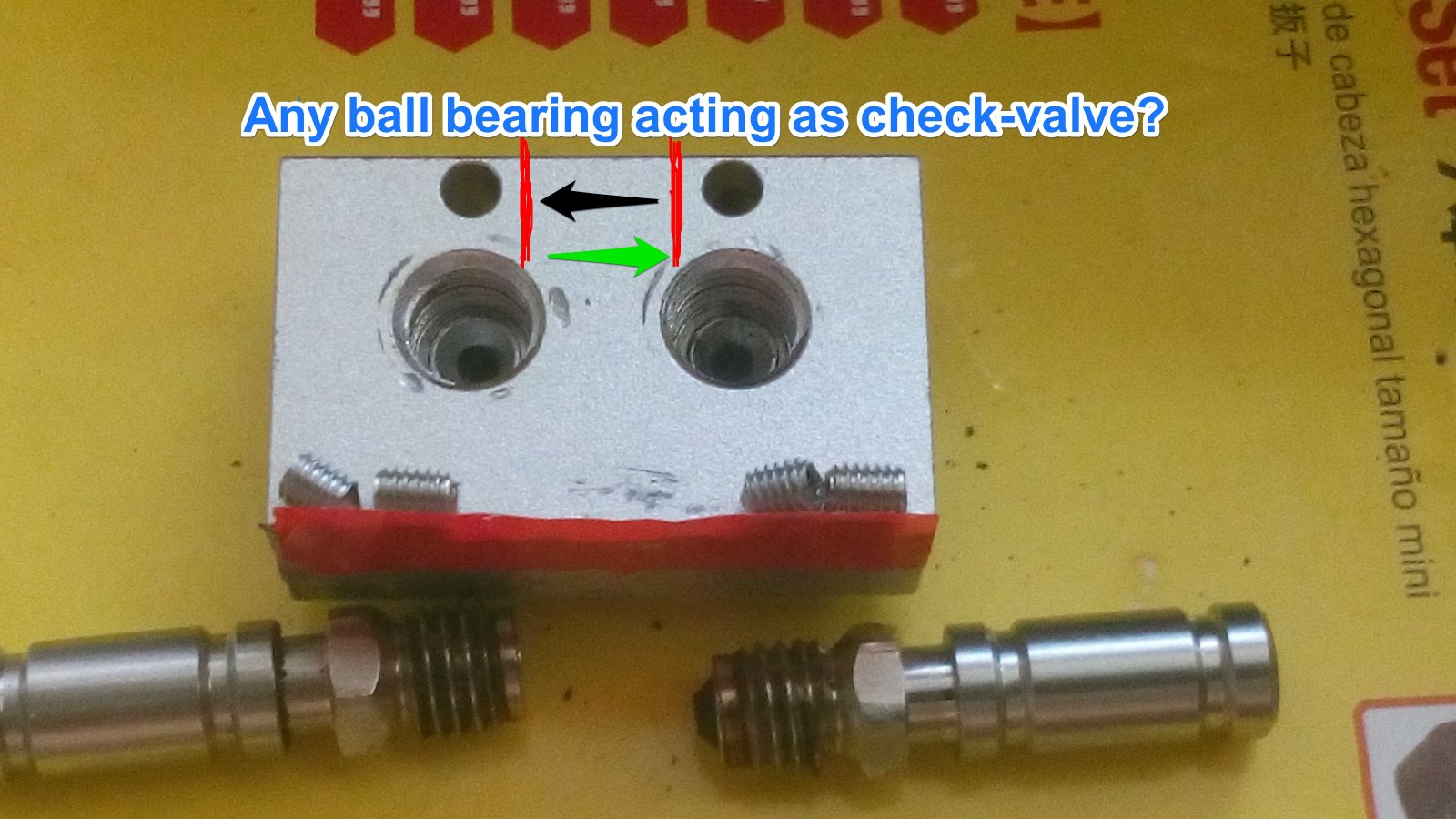

Please advise anyway to buy just the 2 nozzles found badly clogged in photos sent.
Buying complete hot-end is easy way out for 1-for-1 swap.
Thermistor, 2 fans and heating element with thick red wires still okay.
Also confirm any ball-bearing(s) inside aluminum heater block after 2 pairs of grub screws removed
(blue arrow with blue text). If none, advisable to drill straights through?
Thanks a lot
A10M Hot-end -- Very Bad clogging at Nozzles

Re: A10M Hot-end -- Very Bad clogging at Nozzles
Actual photo here amended. Thanks.
- A10M Hot-end Nozzle.jpg (267.67 KiB) Viewed 7084 times
Hi,it is with ball, no need to drill through.
Possible to get diagram (photo showing A10 below) of A10M hot-end that may show
ball-bearing inside heater block acting as check valve. Thanks.
P.S. -- Best only front view of A10M diagram.
- A10 Hot-end.jpg (260.91 KiB) Viewed 7071 times
- A10 Hot-end 4 grub screws.jpg (230 KiB) Viewed 7071 times
Ball bearing, 1 or 2, apparently stuck in solid gunk.
Can Acetone dissolve this gunk to free up the ball check-valve
to function properly?
Cannot drill out unless diamond-tipped drill is used.
Hi,it is not recommended that you remove the check valve as it will block the hotend.
