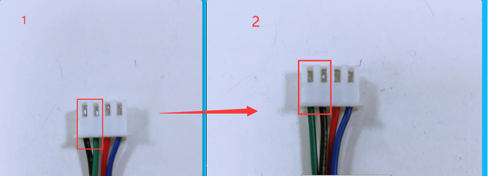

Hi, you can directly exchange the wire sequence without changing the firmware. As shown:
