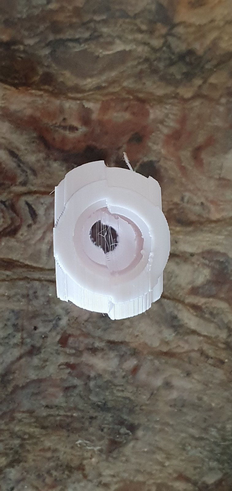

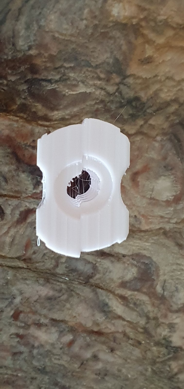

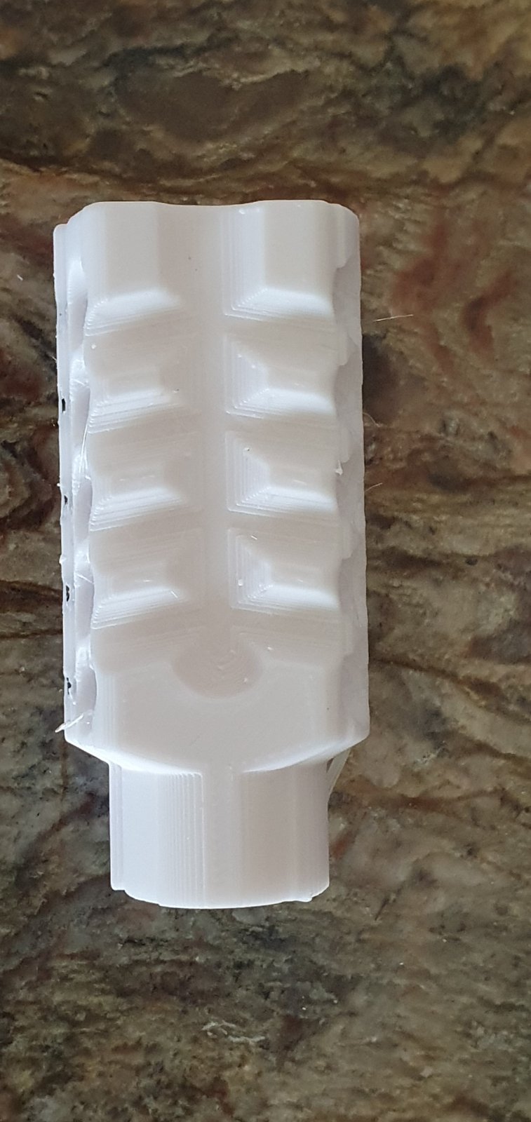

Using Cura 4.9.0 and A30T and tried my first two prints.
At 50% through printing the same .stl file ( but with differing settings in Cura) I'm getting about a 2mm shift in Y axis for the remainder of the print.
Photos are a top view with two end views.
I've no idea if this is a Cura problem or a problem with the A30T.
The .stl model does not have this shift, nor it it apparent in Preview or post Slice.
Tomorrow I'll try using either Repetier or Easy Printer but some input from here would be appreciated.

Hello, the reason for the layer shift may be the printing speed is too fast or the tightness of the belt.
You can reduce the printing speed to 40mm/s, and tighten the belt appropriately to see if you can restore the layer shift.
If the layer shift still occurs, it is recommended to update the firmware, it may be a firmware problem:
https://www.geeetech.com/download.html?download_id=52

Thanks,
I'm on Firmware V1.02.03 and the print speed was15mm/s
Checked all the belts.
I rotated the model 90° an it printed without a problem.
Printed other models since and the problem has not occurred.
It's a mystery!

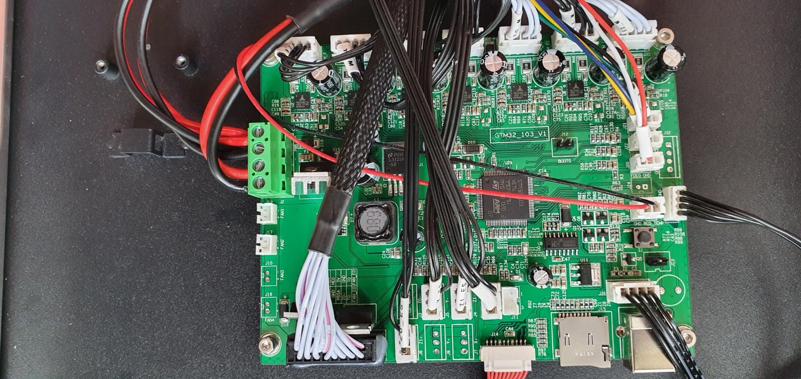

a) I don't think my motherboard GTM32_103_V1 is compatible, drivers not removeable. See Photo.
b) I could physically fit them but the programming is way beyond my ability.
I've asked Geeetech if there is a motherboard for the A30T that has removeable stepper drivers. Not holding my breath.
If you find a solution to a) and b) above, I'd be very grateful to hear and also instructions re programming!

Reply from Geeetech:-
"Hello, thank you for your letter.
At present, the latest GTM32_103_V1 motherboard does not have a version that can replace the driver. Only the old motherboard can replace the driver, but it is not compatible with the new printer. This is the wiring diagram of the two motherboards. You can see that there are many incompatibility.
Regards."
