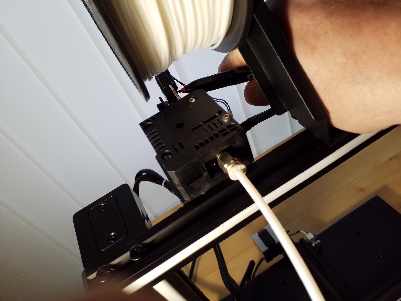

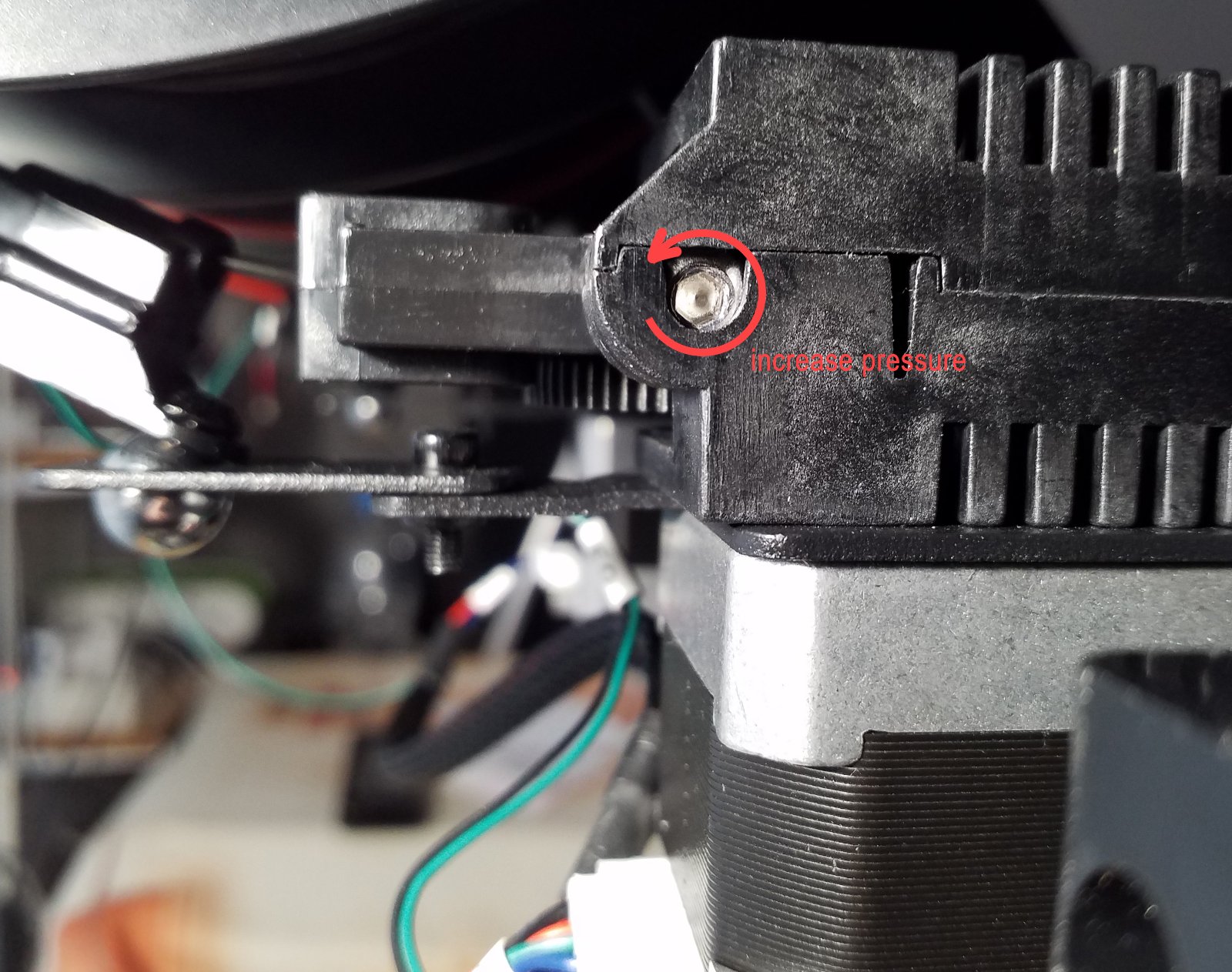

I have noticed that the extruder levers do not press the knurled transport roller firmly enough against the thread. Therefore you should check if the lever for unlocking the filament is really heavy. If not, you can increase the contact pressure by turning the Allen screw to lings. Then check the filament feed by marking the filament with a pen in front of the extruder. The filament should now be pushed well into the opening of the extruder.

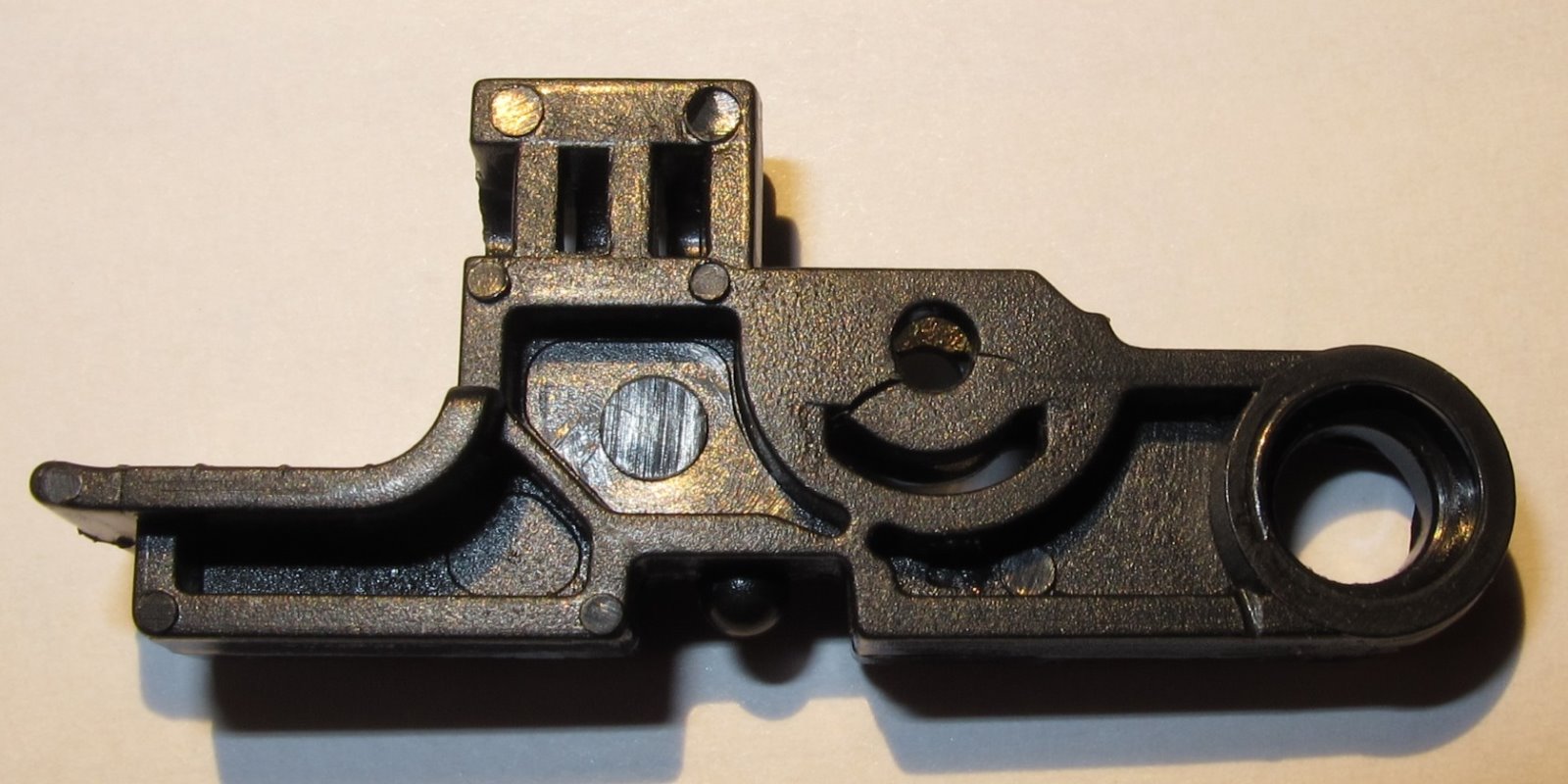

I have had the same Problem on both auto feeder after 3 weeks. I opened them and figured out, that the leg that pushes the roller against the gearwheel has cracks to the center fixation. In my opinion a construction weakness and a replacement will have the same Problem after 10 to 20 hours of usage. This leg must be made of Metall and not plastic.

Seems like the "idler arm" is a problem area ... in fairness to Geeetech, the same thing happened on my Ender 3. There's been a lot of discussion on forum thread: "New A20M couple of problems" and some others as well.
Here's a link to page 2 of that thread:
viewtopic.php?f=108&t=69809&start=10
You'll see a post by jarda3d with 3 suggested designs (Thingverse) for printing the arm. I had success with the second one.
https://www.thingiverse.com/thing:3456879
Somewhere there's a recommendation of what to do if you have one extruder not working so you can print this part with the working extruder. It seems to not be a good thing to just leave the other entry port to the hot-end without something in it. I admit I just used my Ender 3 to print the idler arm.
I've been using my printed idler arm successfully for the A20M since my posting on Jan 9, 2020.
