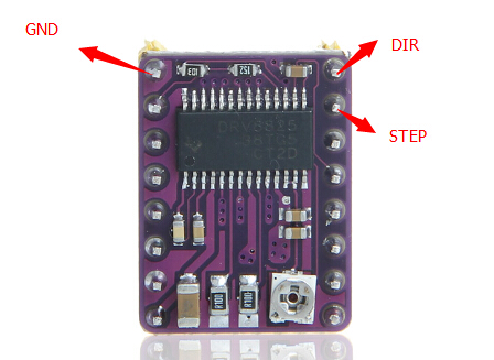

1.Have you ever connected it in the wrong direction?
2.If you change the position of all the DRV8825 freely,did the faulty one still doesn't work while the others work well?
3.Use a multimeter to test the faulty one's voltage between the pin STEP and GND,DIR and GND.
Please tell us the results after you tested.We will confirm it and give you further solution.

- ]~XS0_WB~PI63IS6R1FZLRE.jpg (111.58 KiB) Viewed 9822 times

1 - I connected it only as it should, potmeter towards the power connectors on the RAMPS board
2 - When I put in another DRV8825 in this position, the motor (extruder) works. So the fault is in the DRV8825
3 - i measured the following with 12V supply on the ramps:
Step-gnd 2.3 mV
Dir-gnd 2.3 mV
