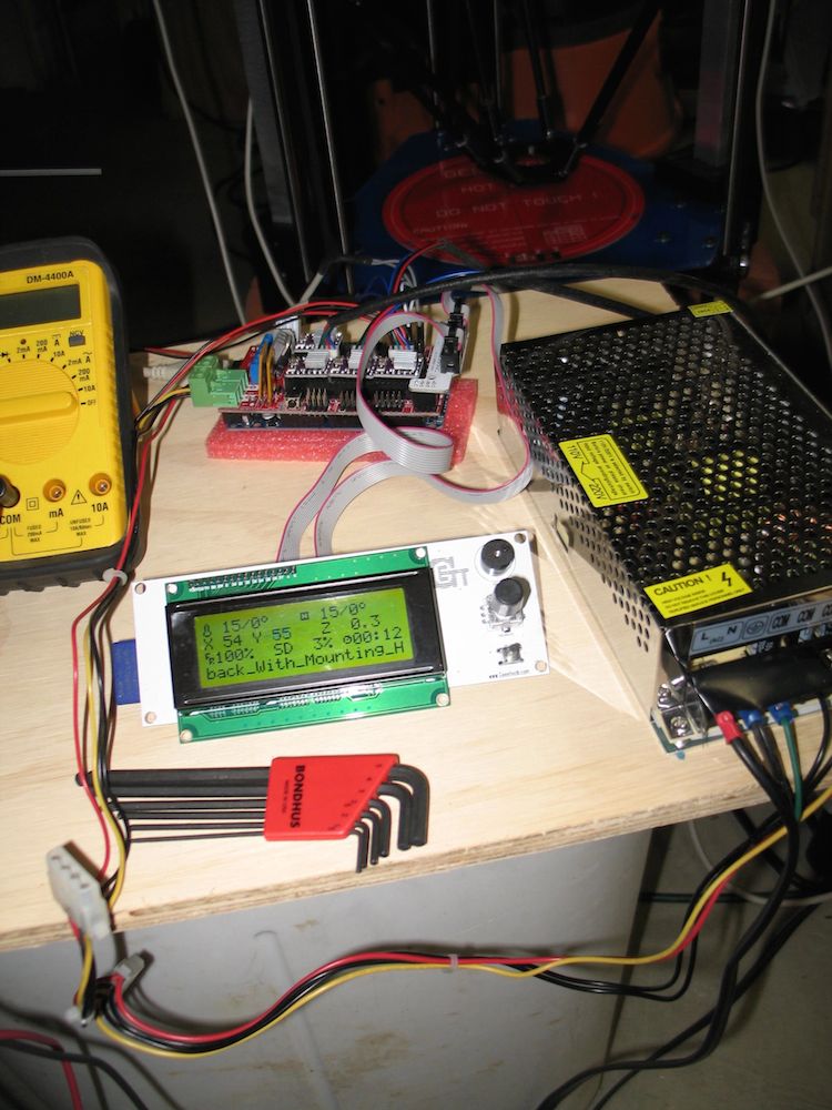

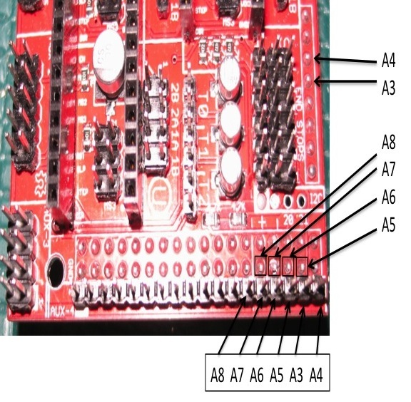

I just opened up a brand new Geeetech RAMPS board the LCD2004 display had random characters on the screen also. Moved it back to my Acryllic I3 and LCD was fine. I have the RAMPS mounted to an old "Italian" Arduino MEGA2560 I had from my LED light show left over. Went to trace the problem. Ohm'd out all the LCD input linews and the lines ohm'd out fine. Re-tried, still random characters on the screen. Decided to re-flow all the input pins that come from the MEGA to the LCD Adapter card on the RAMPS board. Here are the pins listed in the picture diagram.
After re-flow the LCD display now works perfectly:
Using the LCD for my scratch built Rostock printer with motors/bearings/most electronics using Geeetech parts.
