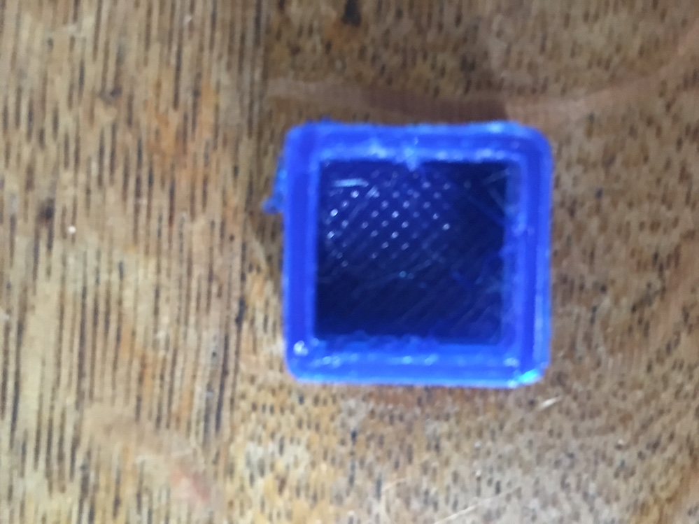

problem is simple: the firsts layers (around 10 of a 40 layers objects) are printed very good. Extruded is well positioned, good distance from heating bed, everything is OK. But after few layers, the extruders is more and more touching the printed objet, and it finally make it move... The object move and the print is going to garbage.

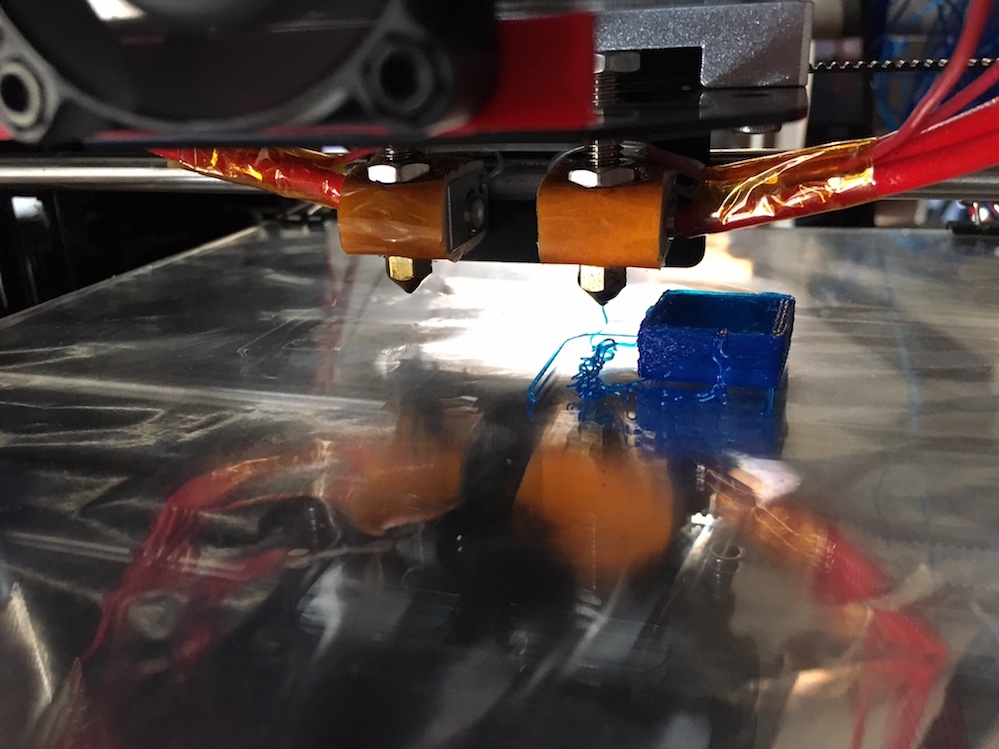

You can see the extruder touching the object in the border...

Every print i make, no matter the object (only calibration object for now), it's same results: the 1 to 10 (around) first layers are perfect.
firsts layers are perfect. Extruder is well positioned from bed, and everything is good

And after,the extruder seams not to get enough height, and begin slowly but surely to touch the object.

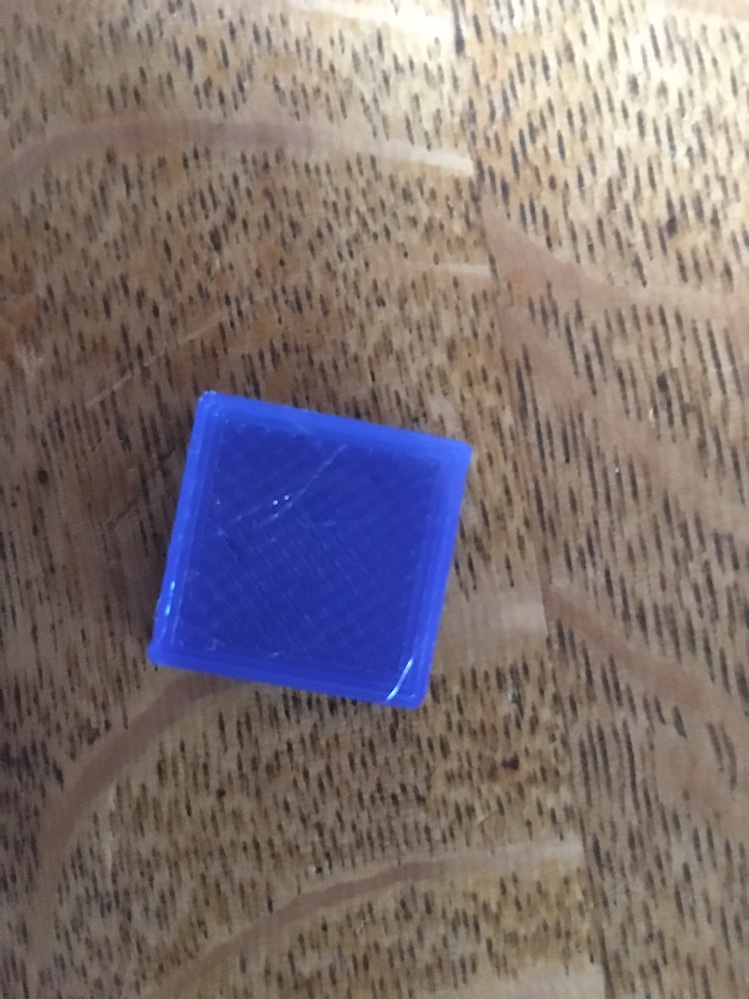

extruder has touch object too much. object has moved, and now it can't finish printing

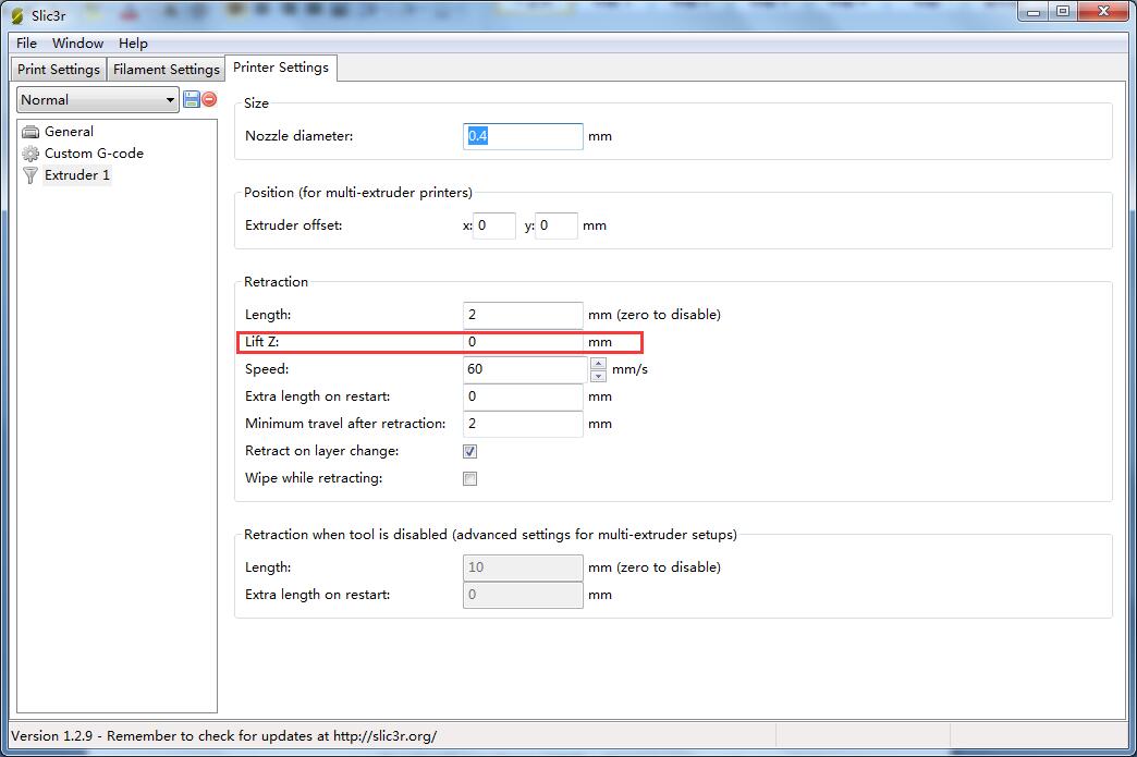

Also,have you tried this setting before?Enabling this option will cause the nozzle to lift up a set distance above the previously printed layer before moving to a new location. When it arrives at its final location, the nozzle will lower back down to prepare for printing.
