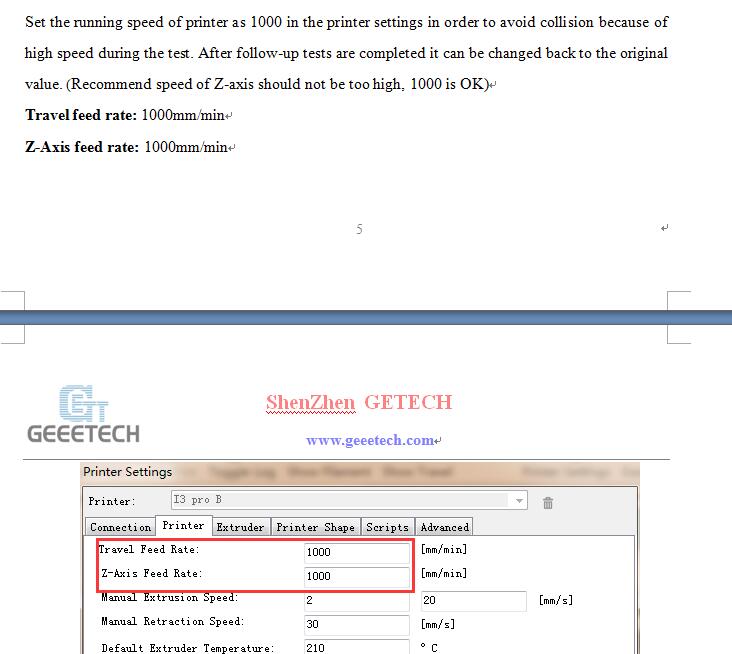

I think the speed recommended in the Pro B user manual is OK:

Hello William,
objection...
if you are reading this in sequence:
- Change the Repetier Host default value for the speed to 1000mm/min to slow down to check the motor direction
- "After follow-up tests are completed it can be change back to the original value
But the original/default value in Repetier Host is 48000mm/min (80mm/s) ... IMHO very fast.
On the other hand 1000mm/min (16mm/s) is very slow.
Do you mean 48000mm/min for X/Y Axis and 1000mm/min Z-Axis is recommed?
maybe someone from Geeetech can give a recommend value, or confirm the 4800mm/min value?
Thank you!
Greets Alex
