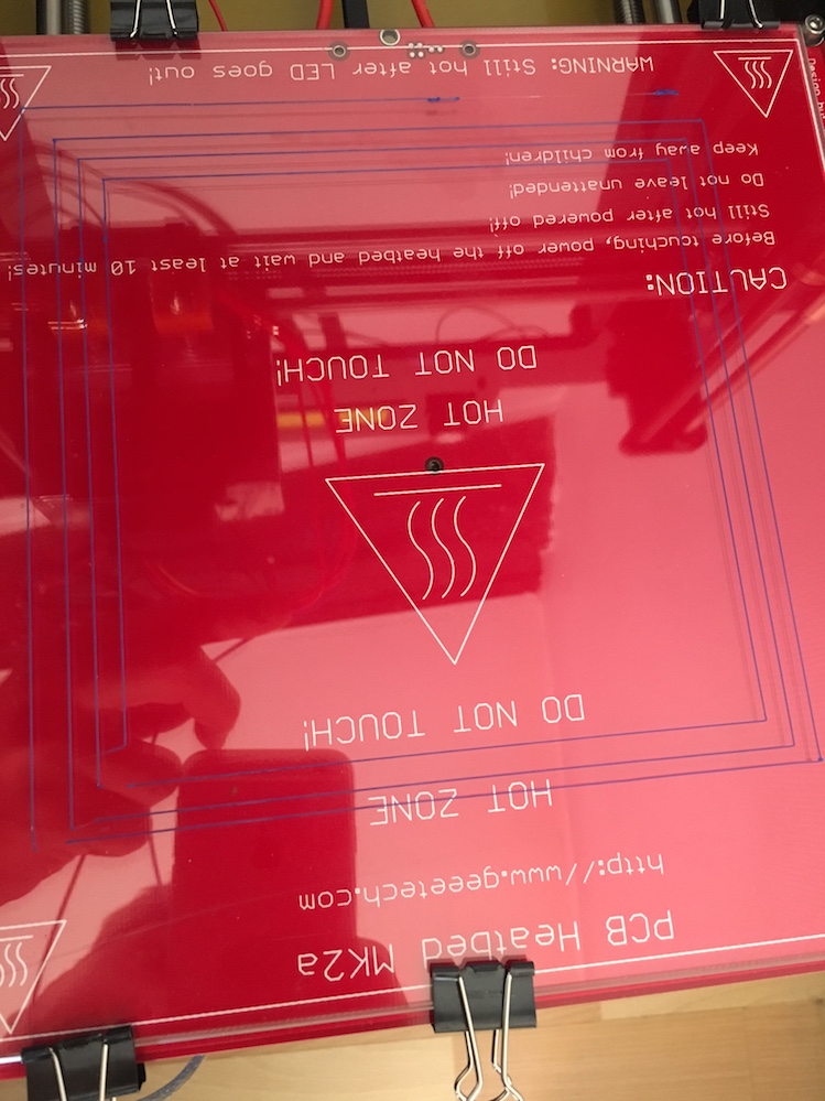

Complete object overview - Top is beginning, bottom end.

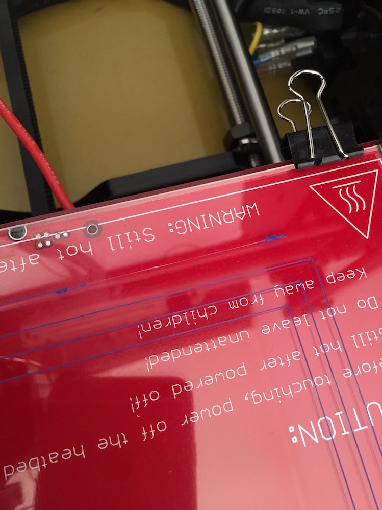

1) when it begin to print it's 'over printing', which means it goes too much out when it begin, creating a big bullet of plastic. (see details picture below)
2) because of this, it fail to make a complete line at the beginning.
Beginning of printing; To much at start, then discontinuated line, then OK

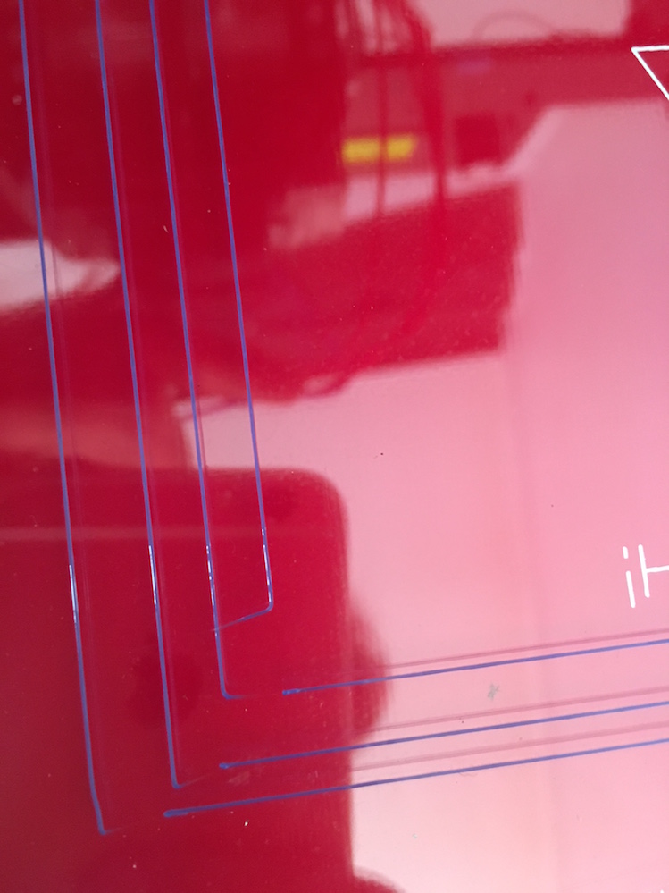

3) in one specific angle (bottom left), you can see it has a discontinuation. When the X axies is moving, i think there is a problem, but it's only doing it on this corner.
Bottom left corner, there is a problem here
Otherwise, it seams OK for the first print.

1)You said the extruder created a big bullet of plastic when it began.
==It is normal,cuz the extruder is not ready to extrude at the beginning,and it will get normal in a short time.As you see,it just appeared when it began to print.
2)About the discontinuation in the specific angle,i guess the too close distance between the nozzle and the heatbed caused this.You can adjust the wing nut near the corresponding corner to avoid it(There are 4 wing nuts beneath the heat bed).
