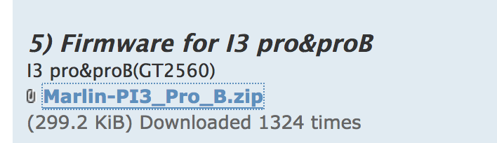

-To install the Marlin firmware I rolled back to Arduino 1.0.6 to get around the compile error with later versions --> "using typedef-name 'fpos_t' after 'struct'." Success.

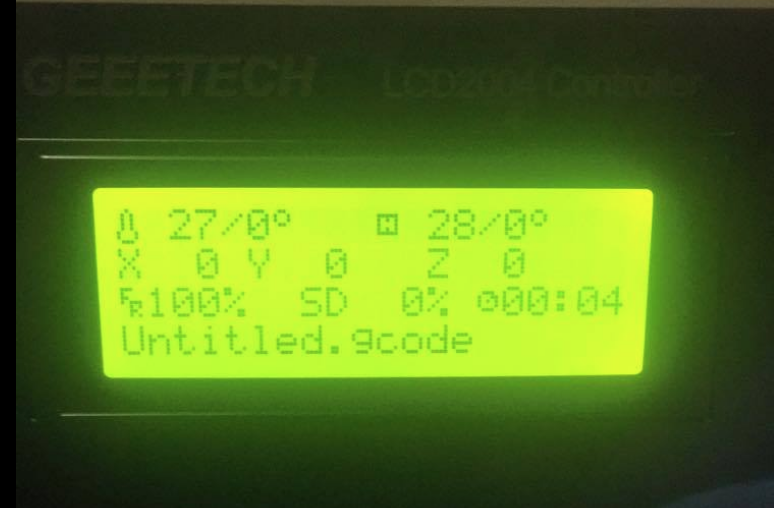

Update - removing/reinstalling Marlin driver fixed the LCD & screeching & I thought it would then be wise to try & print from a gcode file on an SD card.
The result is the same as when hitting 'run' in Repetier Host... the Pro B doesn't do anything. I can see the file on the LCD screen & select it just fine, then i just see the following screen. Looks like the extruder & heat bed aren't getting started/not heating up.
Also - i should add, in case it helps narrow in on the real issue. I can move all axes through "Prepare" --> "Move axis" --> "Move..." so all motors seem to be functioning.
Any ideas?
