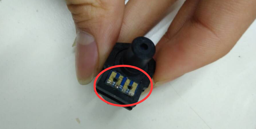

I'm not able to get the E180 to heat beyond about 5-15 degrees, even after about 20 minutes. Any advice?
Re: E180 Temperature won't Go Above 5-15 Degrees (C)
I think you can remove it out and clean it then install it to the printer.
contact point.png (237.82 KiB) Viewed 8555 times

Also, if your contacts have noticeably large lumps of solder on them, remove them with a soldering iron ... otherwise contact is bad and temperature readings will be false.
