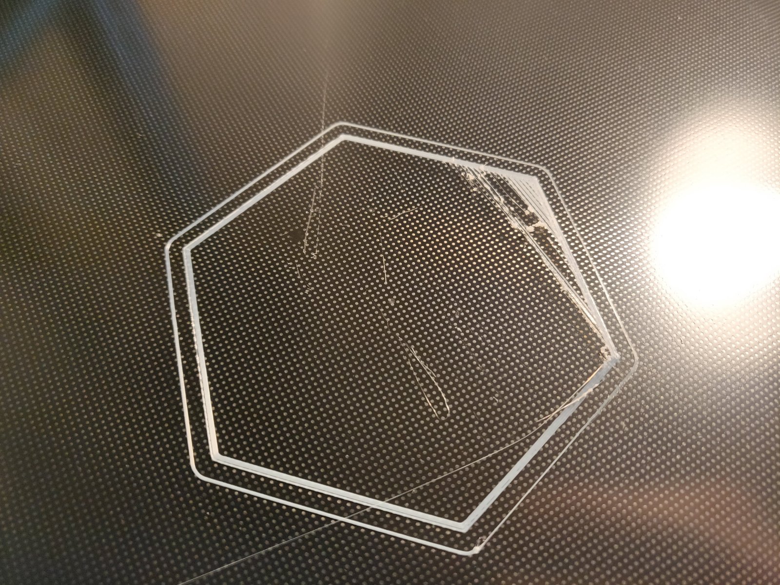

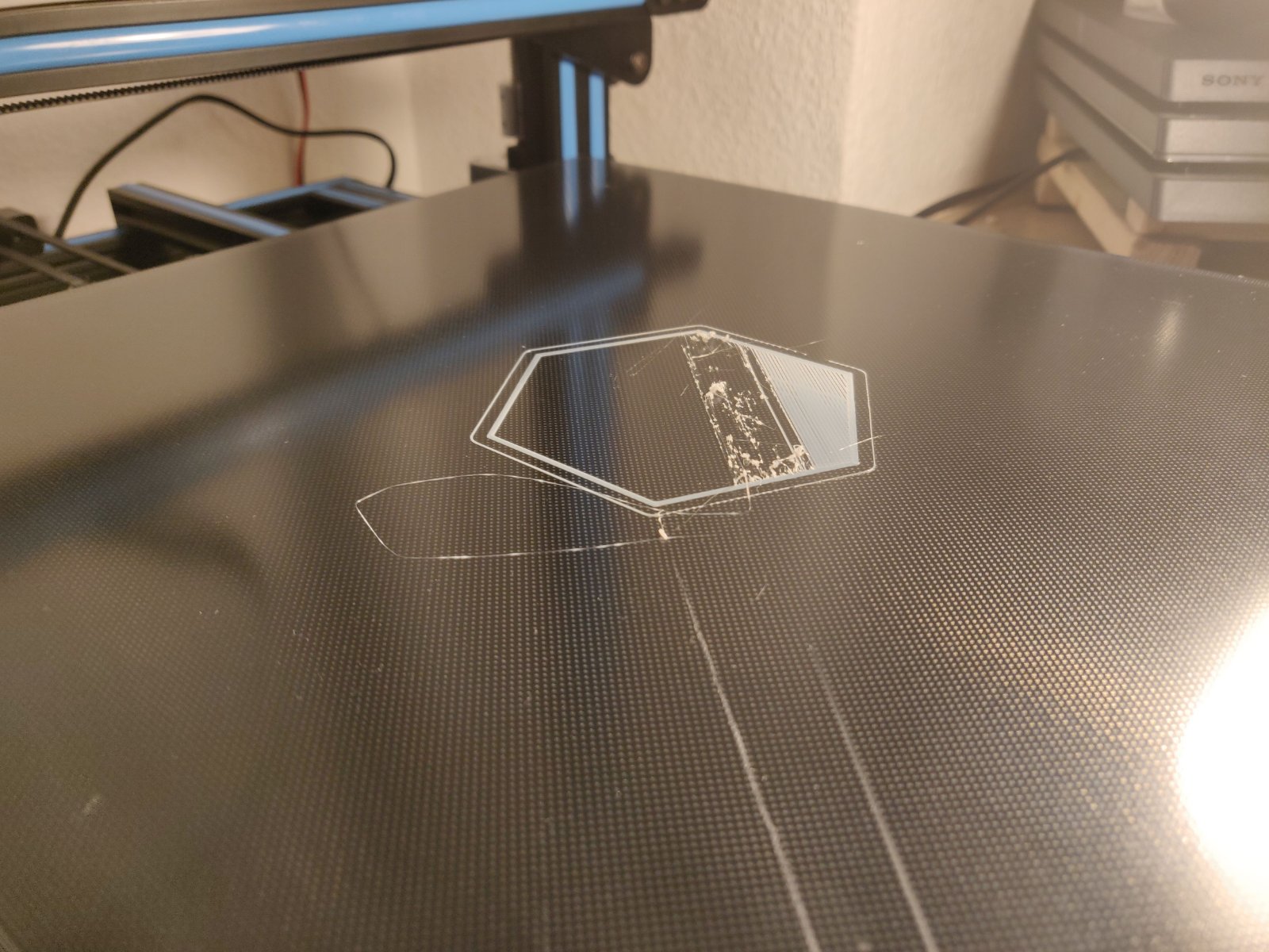

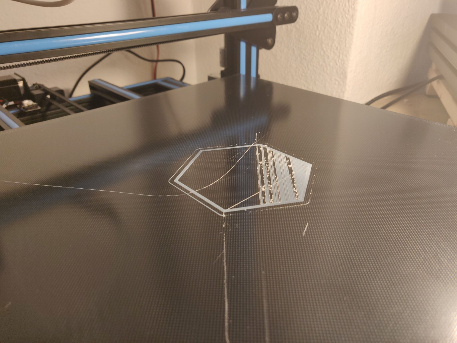

I dont know what the issue here could be, I made my cura settings according to a tutorial, and I am using Geeetech PLA filament.
I attached some photos of 3 prints, each with differend temperatures, can somebody see what the problem could be?
(I thought it might be a clogged nozzle, but would that happen everytime at the same time? I can press filament through a few seconds after I end the print.)
dogmatic69
Posts: 11
Joined: Sat Oct 06, 2018 2:27 am
Re: Print fails at layer 1 every time
Post by dogmatic69 »
Nozzle is too close to the bed, filament cant come out enough to stick. Raise the offset.
