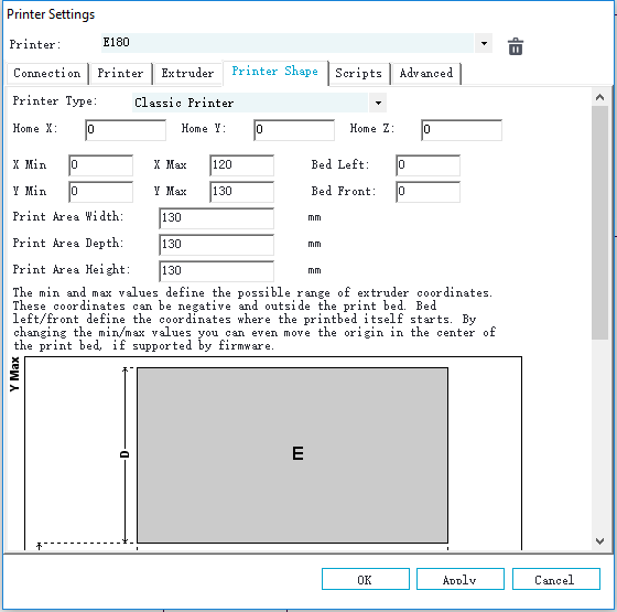

Here is my E180 profile for Repetier-Host
E180-HOST-Slicer.zip
(18.73 KiB) Downloaded 1073 times
