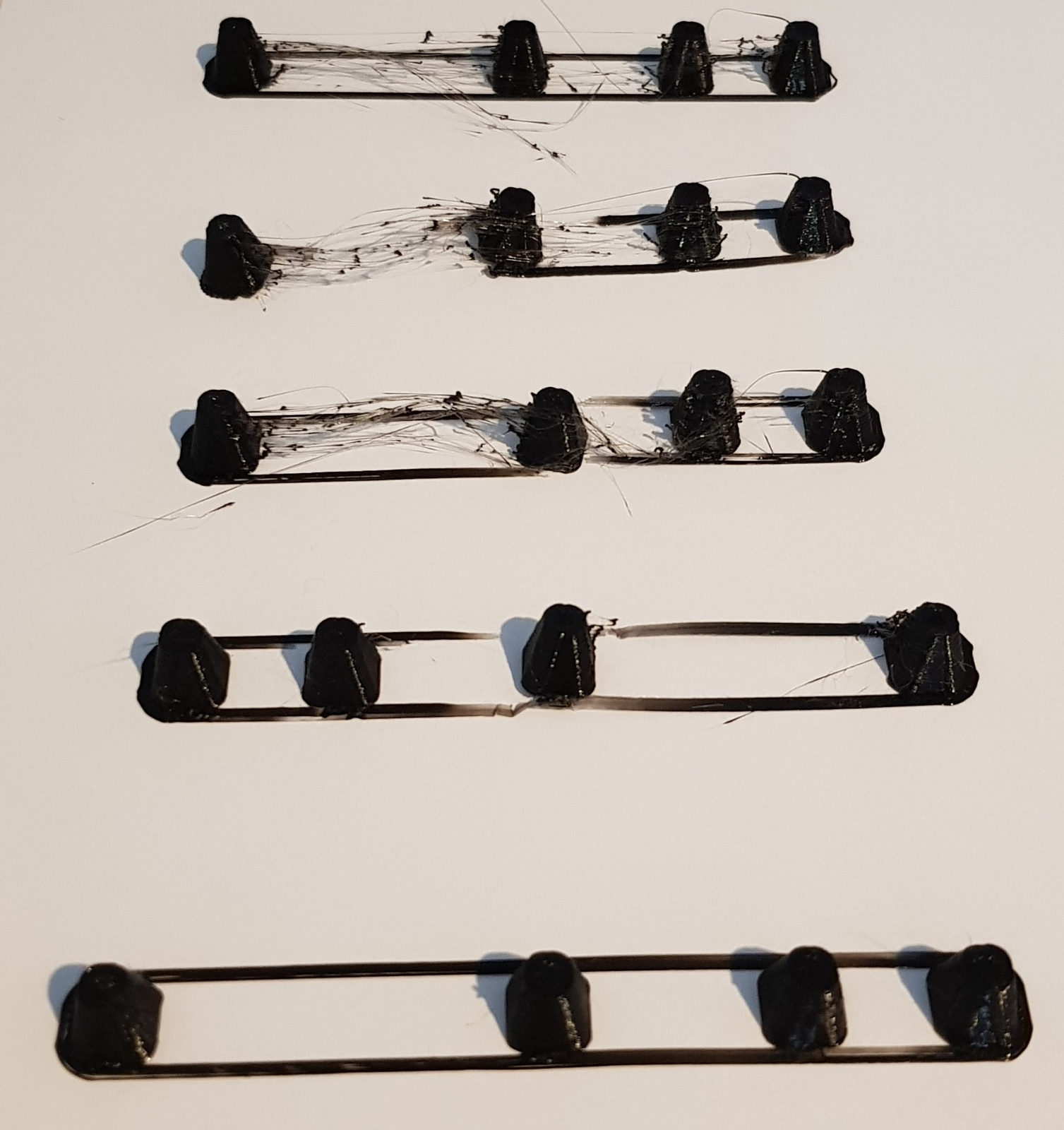

finally i found the right settings and was able to print the retraction test without any stringing. A10m, both extruders in use.
here you can see the history. the final one without stringing is using a lower temperature for my filament (190 in my case) and 200mm/s travel speed with default retraction settings in cura (6.5 retraction, 40mm/s retract speed). The wrong ones are just retractions settings I tried before I found they are not the problem.
so my summary is, just leave retraction to default (enabled) but find the right temperature were your filament is not stringing and definitely use the higher travel speed setting. Also I do not use Z-hop.
I'm using the Marlin 2 firmware with the night builds from user Vert who is also admin in here. I also removed the discs in the hotend as described by Vert in his discord: https://discord.gg/5yACNxr But I recommend to try without removing them first (as that is a hardware change and that is on your own risk if you try it).
Model for retraction test is from https://www.thingiverse.com/thing:2802350

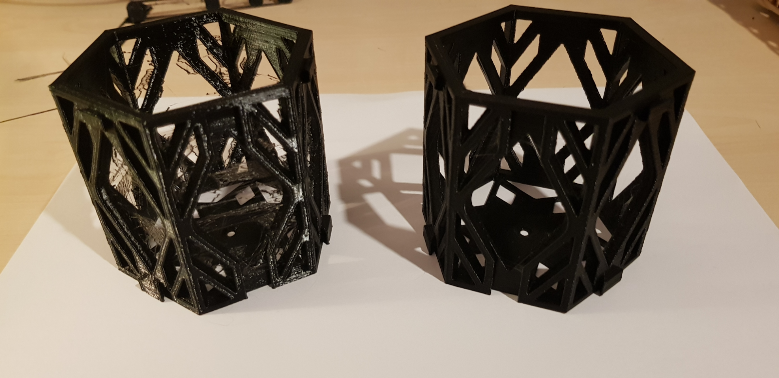

Before and after the stringing tweaks (discs removed, default retraction settings, higher travel speed 200mm/s, lower temperature 190 degree for my material)
