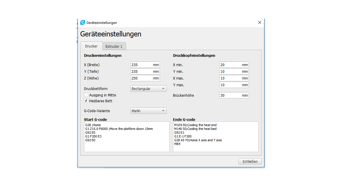

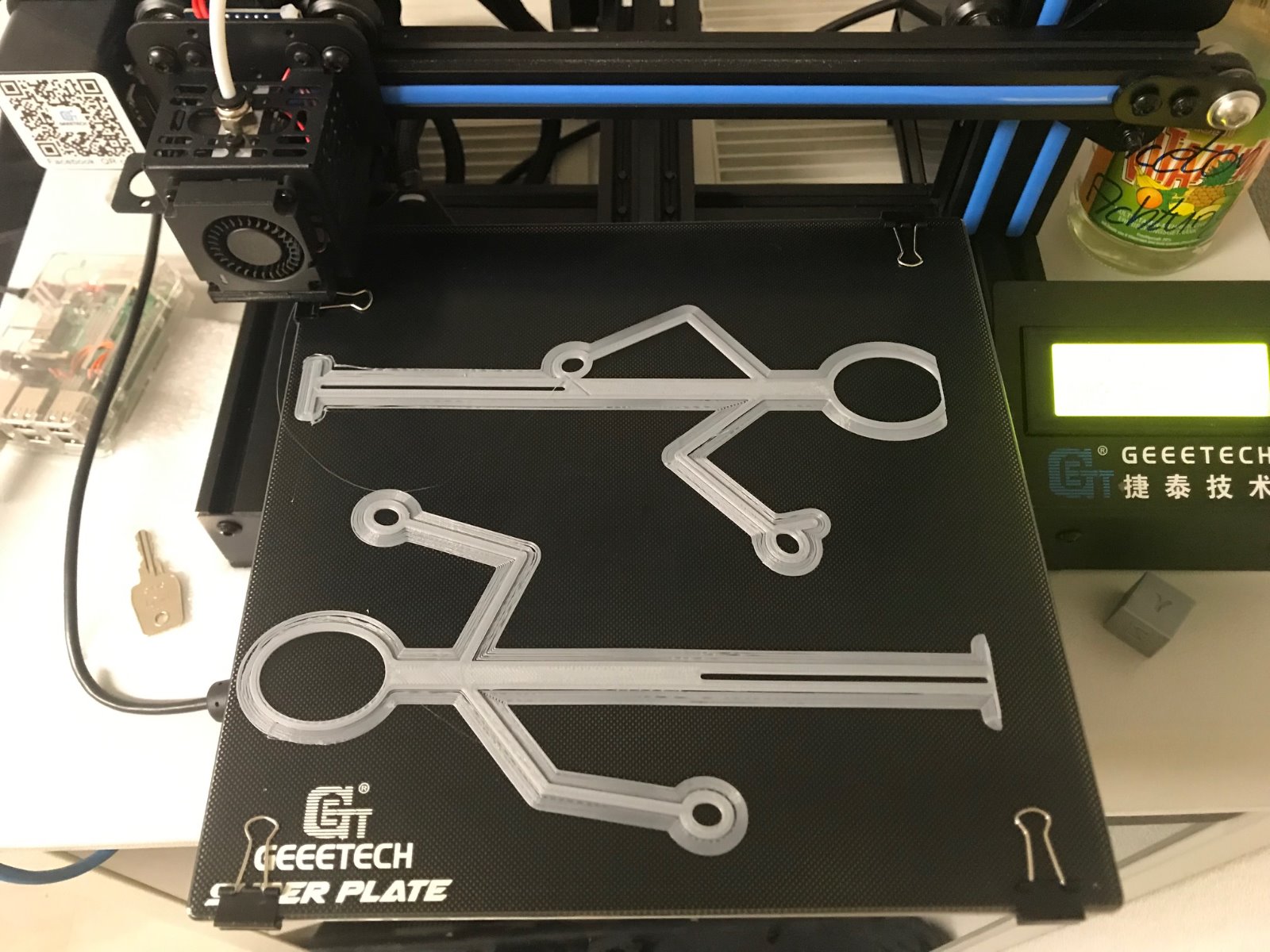

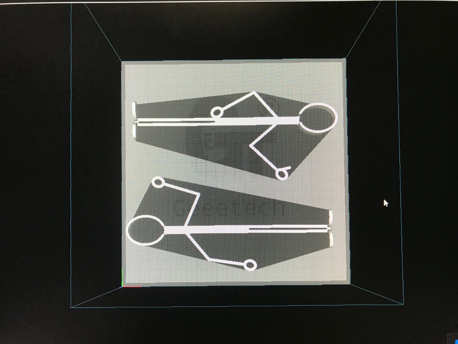

i need help with my Geeetech A10 and the Software Ultimaker Cura.
The print area in the Cura view is not same like the Printer plate.
In the attachments you will see the differentes.
It will be cut off on the right side.
My Cura version is 4.0.0
What can I do against it?
Thanks a lot.

in Cura

on the plate

Oh ,I am afraid you need to change the print volume. The A10 print volume is in the range of 220*220*260.
