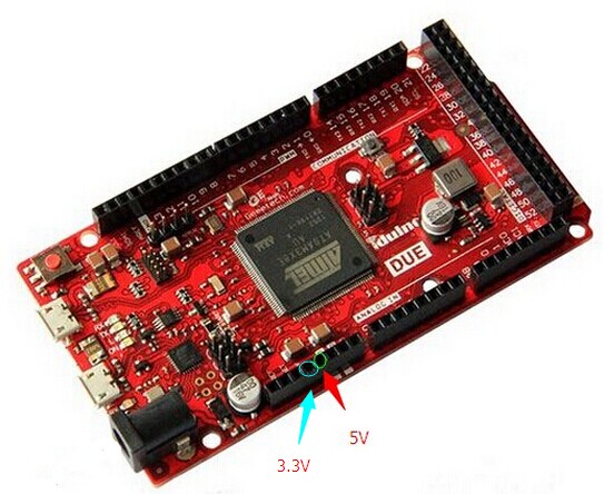

Could you please measure the voltage between the slot of 3.3V and GND when you supply 5V DC on the slot of DUE? I enclosed the picture. Waiting your reply. Best regards.

There is only 1.85V on 3.3V pin when 5V is supplied.
