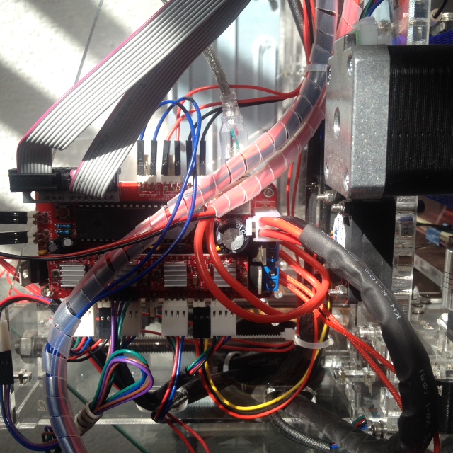

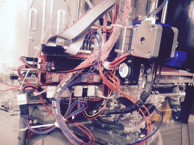

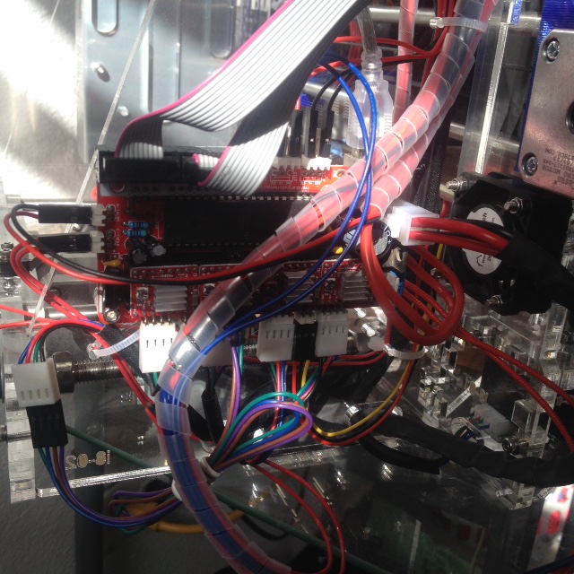

When I turn on the printer it was ok, all the motors was working fine, then i turn on the heatbed, it start to heat, but the fan stop working as well as the motors. then i realized that heatbed was heating continuously more than programed temperature. Then I turn off and turn on everything, the heatbed start to heat by itself then the transistor burned producing fire, now the computer does not recognize the printer. I paid $490 for the printer, I am sincerely disappointed. Hope we can solve this problem.

- Posts: 1405
Re: Heatbed MK2a does not work
No, I need some photos of your printer with mainboard.
- Posts: 12
- Joined: Sun Apr 05, 2015 2:15 pm
Your questions should be clear in order to optimize the time, sending you the photos. Hope the photos will solve the problem
- IMG_1507.JPG (196.3 KiB) Viewed 11019 times
- IMG_1506.JPG (178.68 KiB) Viewed 11019 times
- FullSizeRender.jpg (155.53 KiB) Viewed 11019 times
- Posts: 1405
Please check if somewhere of the hotbed wire is touched. Maybe it is short circuit that caused over high current, so the board is burnt.
