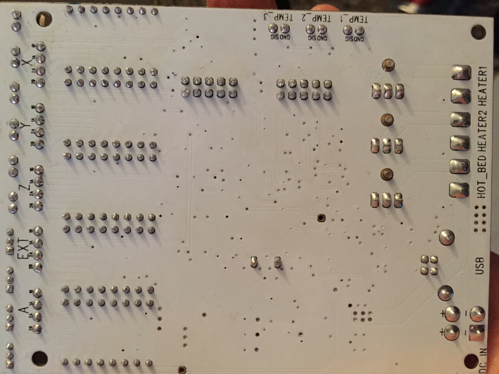

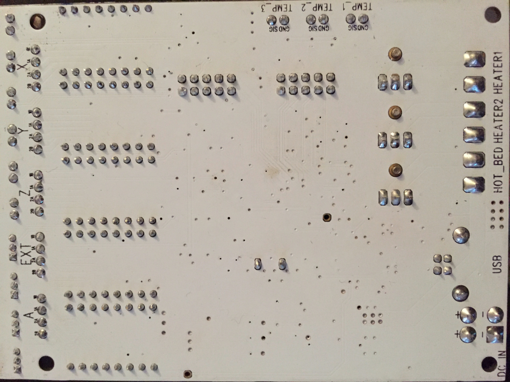

I have since removed my driver board to inspect it. I have placed one driver back in it to show you how they were installed. I found a darker spot on the board. It may have been either dirt or something else. It was cleaned off relatively easy.
Cleaned board
Cleaned board
Darker spot on board
How driver was installed

You mainboard looks fine. I can see the "darker spot" you called.
The switch 1and 2 should bed off if you use DRV8825.
