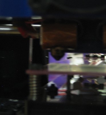

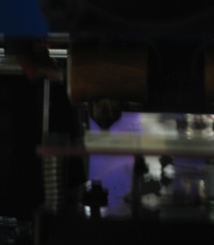

So that you can see the problem, I adjusted the heat bed so that it is touching the extruder nozzle. Then, without moving anything, I set the temperature of the heat bed to 95 degrees. Here is how it looks:
23 degrees
23 degrees
Extruder Nozzle making contact with glass at 23 degrees
After rising the temperature of the heat bed to 95 degrees
The nozzle is not making contact with the heat bed at 95 degrees. The separation is around 1mm.
What do I do?
zhangxueyou
Posts: 1405
Re: Z-axis unreliable zeroing
Post by zhangxueyou »
When the distance changed after your heating the extruder, are the z motors move, or only the nozzle raised itself?
TheDreamMaster
Posts: 51
Joined: Thu May 28, 2015 3:42 pm
Post by TheDreamMaster »
The motors did not move. Either the nozzle rised itself or the heat bed lowered itself.
Please note (read my previous post carefully): I did not change the temperature of the extruder. I just changed the temperature of the heat bed!
