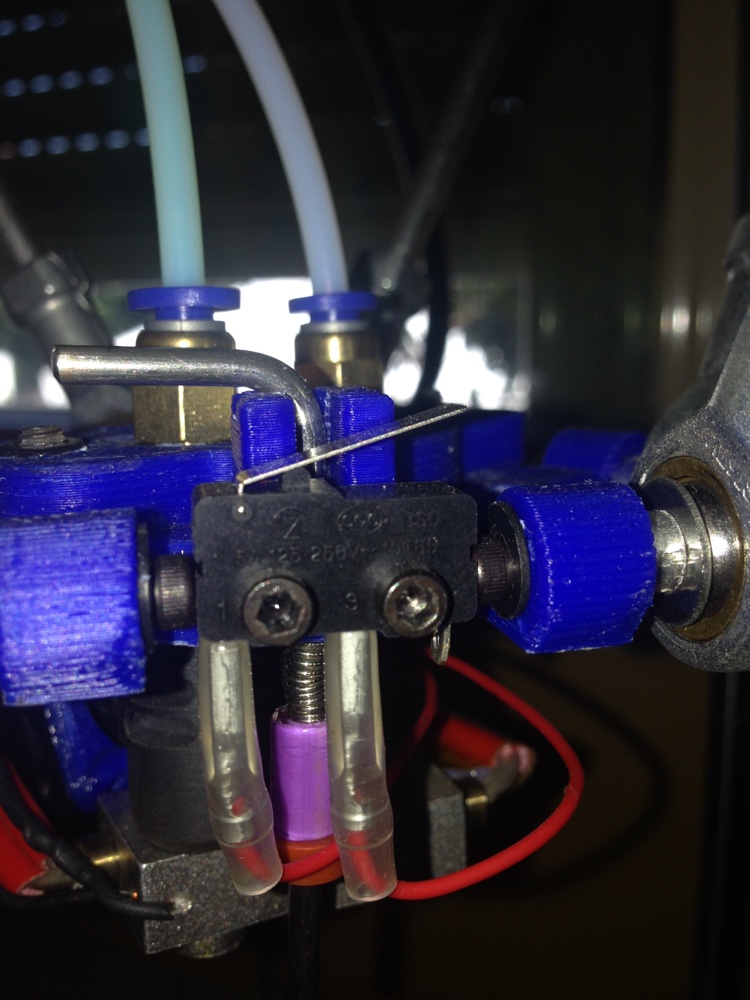

Yes the conection of the probe its correct and its mounted on the right side.

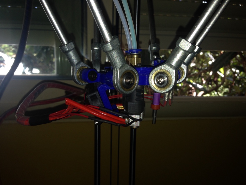

Here Are the pics

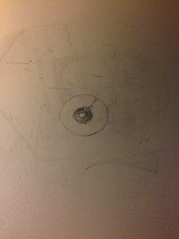

following your advice, I decided star to print. After some adjust with belts and tensioners I have get to print if the pieces to print are small. I start with the lock ring of the probe. I will send you a picture for the result after 11 min of printing....
I´m sending too a platform printed with Prusa I3 that I have built for a friend.
This is the result of print.I think the extruder don't work as expected
Prusa I3 Printed
Prusa I3 Printed
Lock ring.jpg (252.46 KiB) Viewed 13327 times
