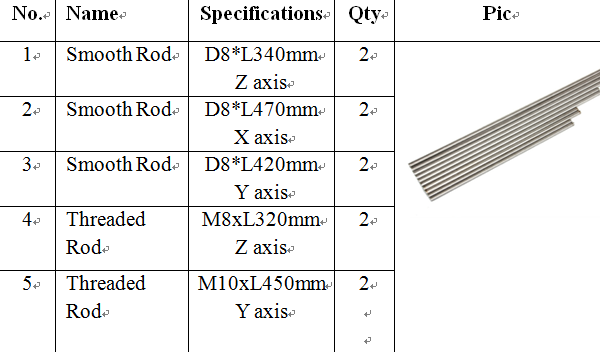

Now here comes the fun part. The x-axis rod I replaced with steel rod from homedepot is still too big. The x-movement is not smooth. My question is, what is the correct diameter for the x-axis rods.

1.Here is sizes related to rods:
