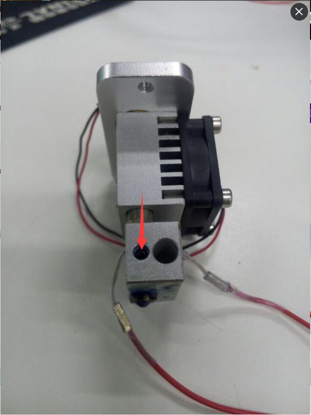

lior@motiontech.co.il wrote:i read the post and its nor the case , the i think the pla is getting to the hot head but its not melting , i know that because i pulled out the pla after i heated everything and tried to extrude some.
Didn't melt?Did it reach the enough temp?You can also unclog the hotend by the two holes of left side and right side when you heating up the hotend:
