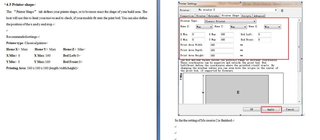

2.Not In The Center Of Heat Bed
Not printing in the center of the bed,there are two possibilities:
1)Did you have a right setting in Printer Settings?
2)Was the size of the actual printing the same as the size of your model?If it wasn't, maybe the step/mm of your motor is wrong.

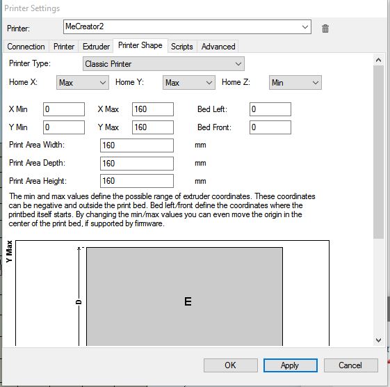

(68.23 KiB) Not downloaded yet
I have verified the dimensional accuracy with my printer, and it is correct.

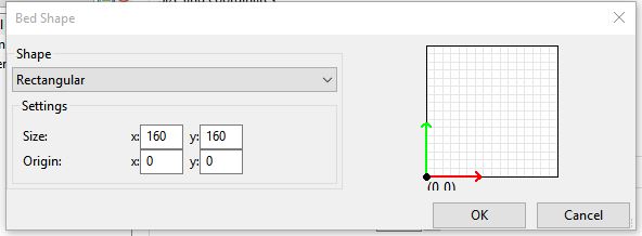

Here are my bed settings in my slicer:
