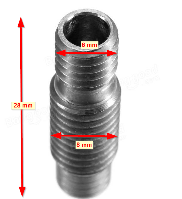

This one:
2018-10-28 19_15_56-Window.png (212.87 KiB) Viewed 13233 times
