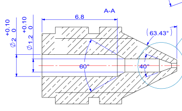

Maybe this part will give you the help.

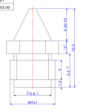

Re: Nozzle sizes on A10M

Thank you! This will be helpful. I did buy some replacements from Geeetech and now see Amazon carries them.

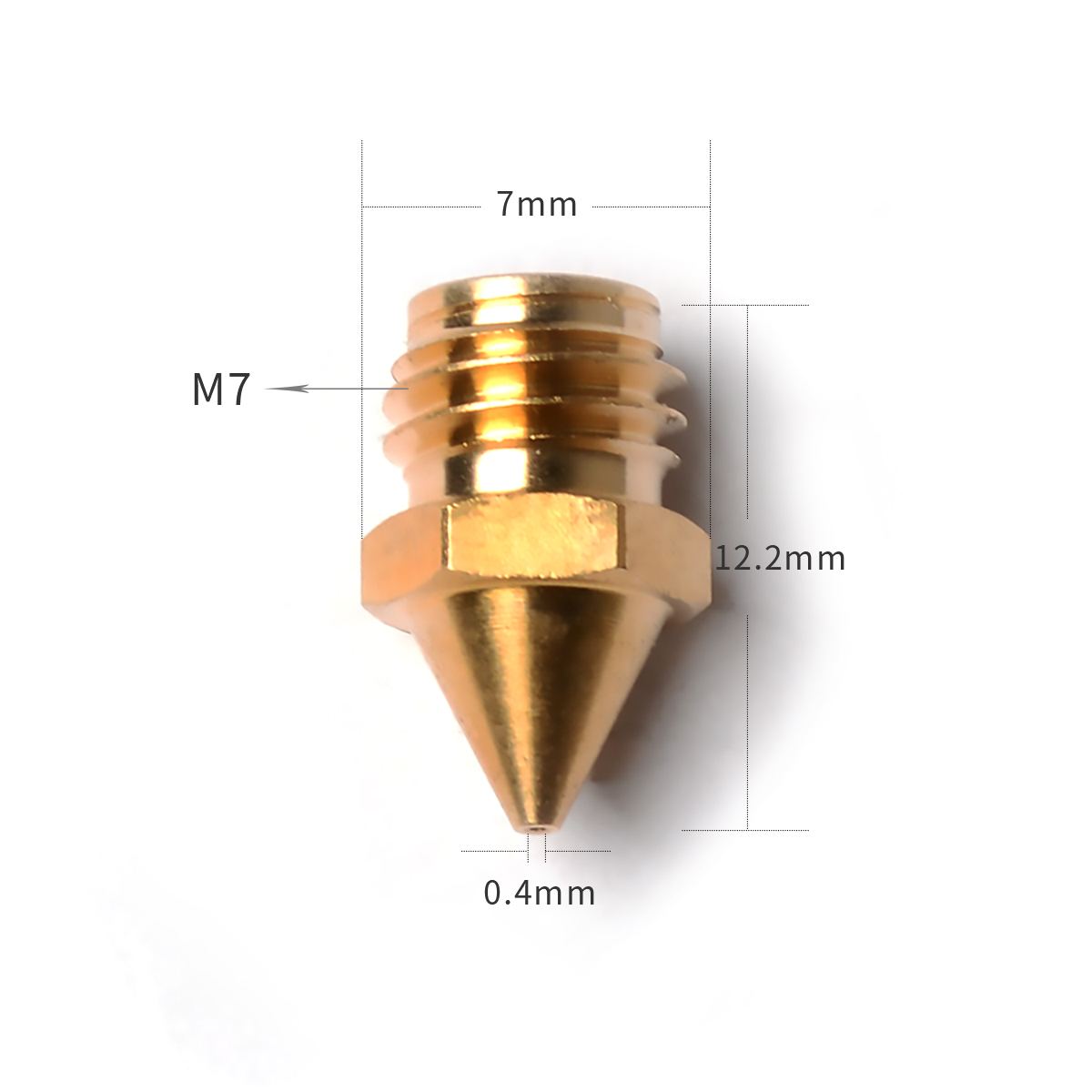

2-in-1-out nozzle is M7

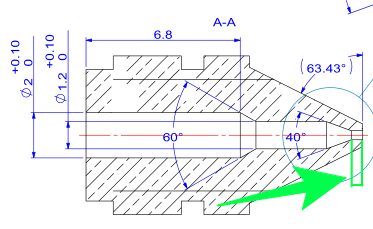

Looking for the nozzle bore depth dimension for A20M nozzle. Same as A10M yes?
The measurement i'm looking for is in green here. Didn't want to start a new thread since some drawings were already posted here. Can you help?
maybe this?

Post by ERamseth »
No that's not the dimension I've highlighted in green...
