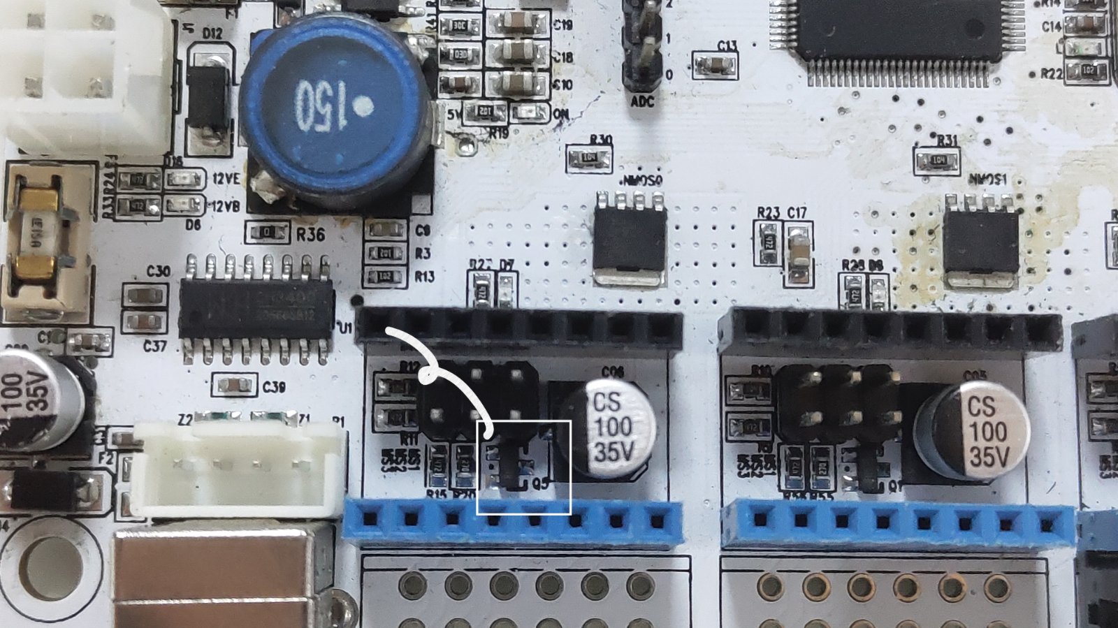

Hi, Q5 position on the GT2560 V3.0 motherboard.
