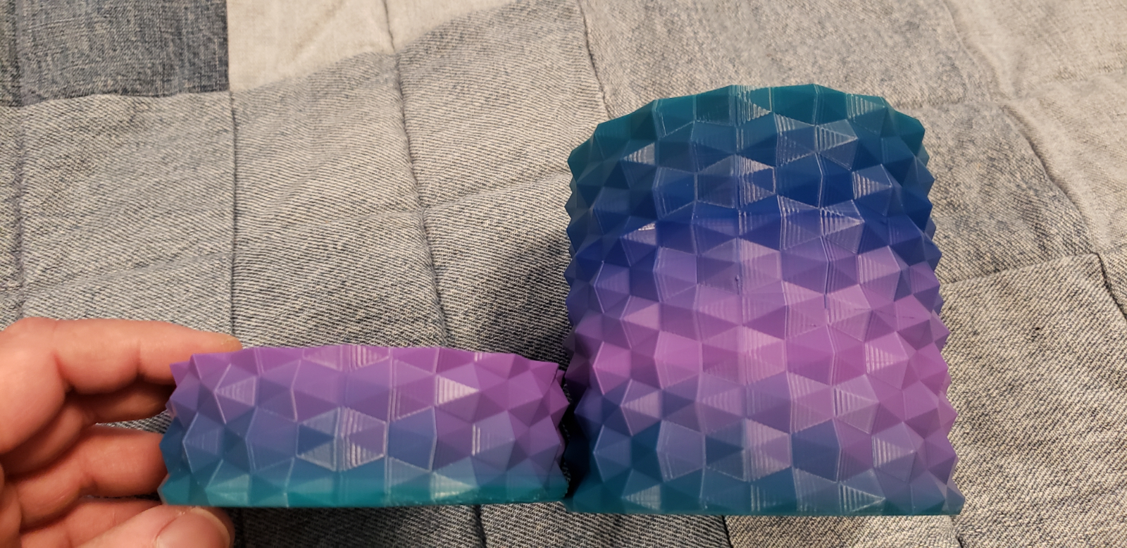

So far it looks like verts is going to do the trick, the mixer menu shows the virtual tools and gradients from tool to tool numbers per my M166 on step one, waiting for step 2 to hit but it'll be 30-60 mins. I did also notice that the last print attempt and this one have an appearance difference as well just in switching the firmware. I'll post pictures in the morning of the single gradient stock firmware object and the same file done under verts firmware.

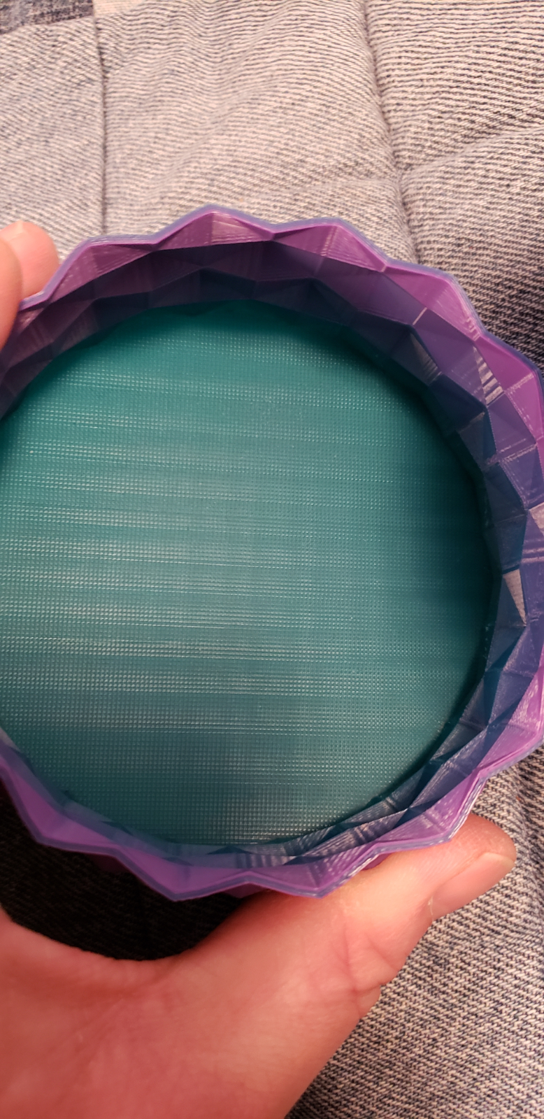

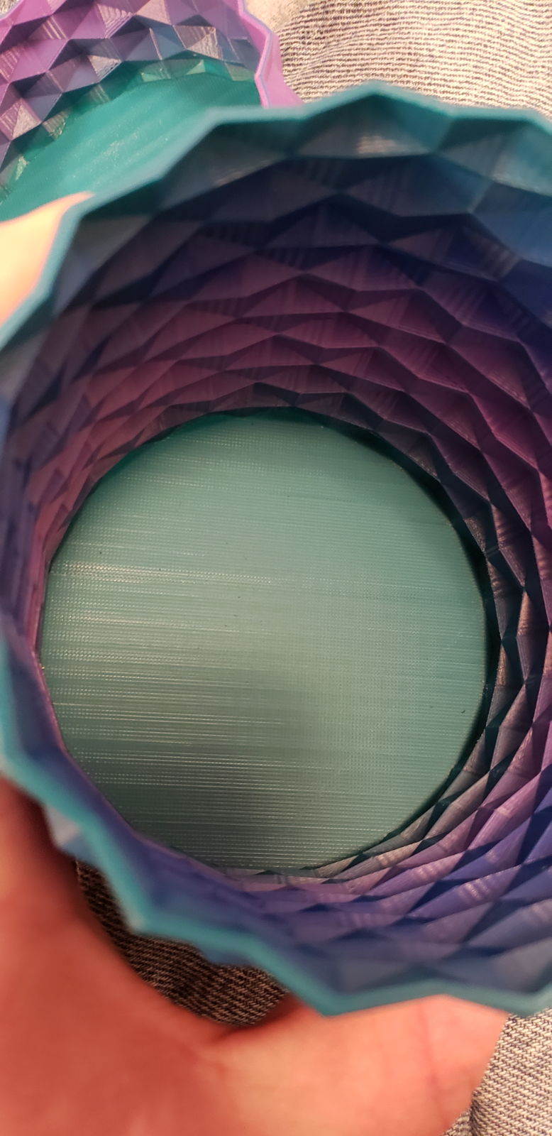

Worked perfectly!
Here's the bottoms of the two, you can't see it all that great in the pictures but the line and line spacing quality seems better with verts also.
