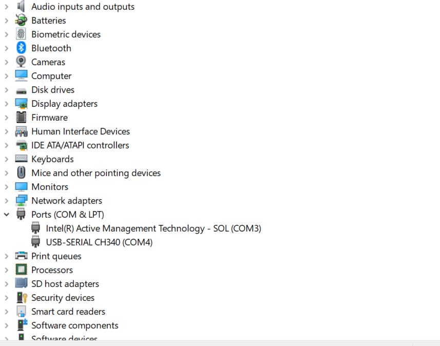

Could you find the COM PORT on device manager?
Re: How to install the firmware for GT2560
Posted: Thu Jan 17, 2019 7:30 am
by gboldiii
Yes, Using Com 4
Screenshot (3).png (138.09 KiB) Viewed 73437 times

From you pic.You have open the Easyprint +arduino.
Could you check the com port used on Easyprint or arduino?
Or you can try to click"reset"on the motherboard when you try to upload.
