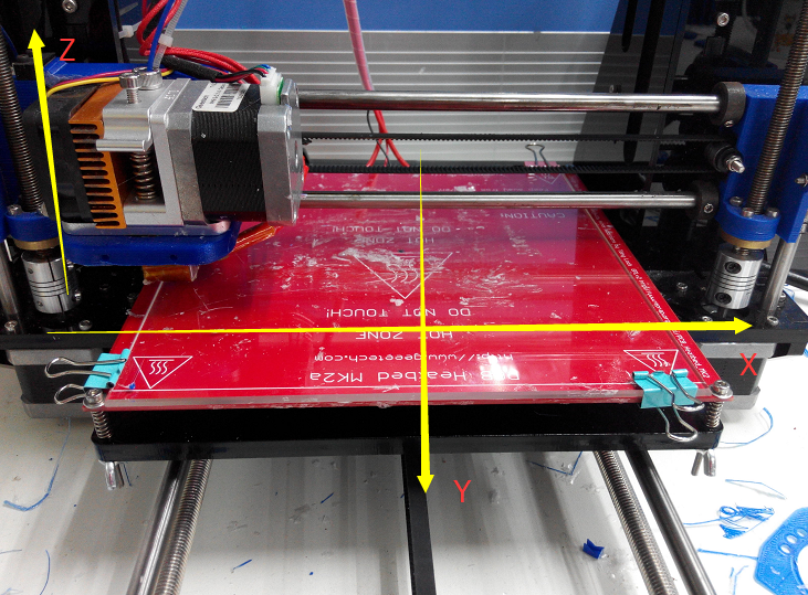

About the endstops, please recognize every axis and connect the endstops correctly.
As shown in the picture, from left to right should be x, y ,z .

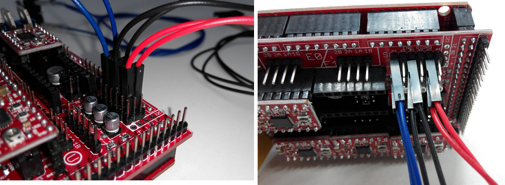

http://imgur.com/a/8L3Kb Here's the end stop.

I think somewhere of the endstop wire is broken, the endstop can not be easily bad.

This morning I switched the wires on the x end stop with the ones on the y end stop. The y is now the black.wires while x is blue. The y end stop still worked with the new wires, however the x end stop did not. http://imgur.com/a/WDrsf
