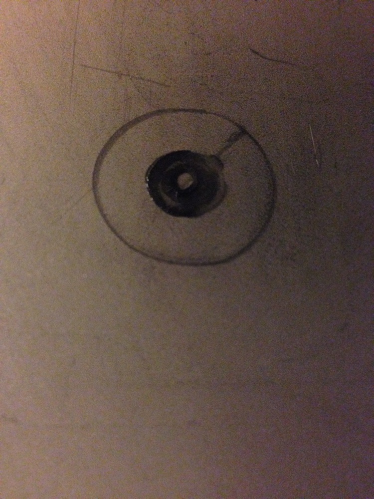

The first thing I´ve done tonight just arriving home was clean extruder nozzles as explained in this forum.Then I try to print the lock ring again using the best quality PLA that I could find in Madrid. Please look the videos and the final result pic.

- LockRing result.JPG (248.69 KiB) Viewed 13887 times

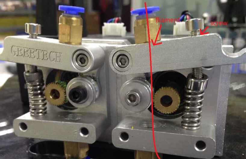

Could the motor turn without the filament plugging in? If not, then check the motor or motor driver.
If it turns, then how about adjust the screw on the extruder? maybe it too tight or too loose for the filament to come through.
- QQ截图20150822162829.jpg (346.36 KiB) Viewed 13879 times

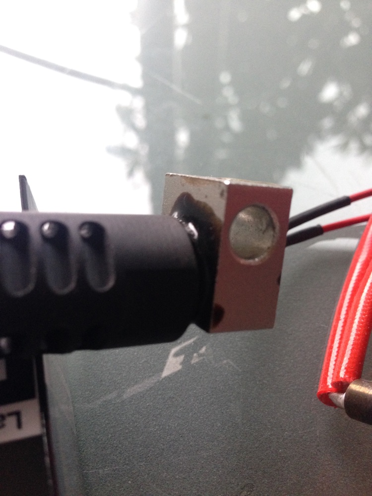

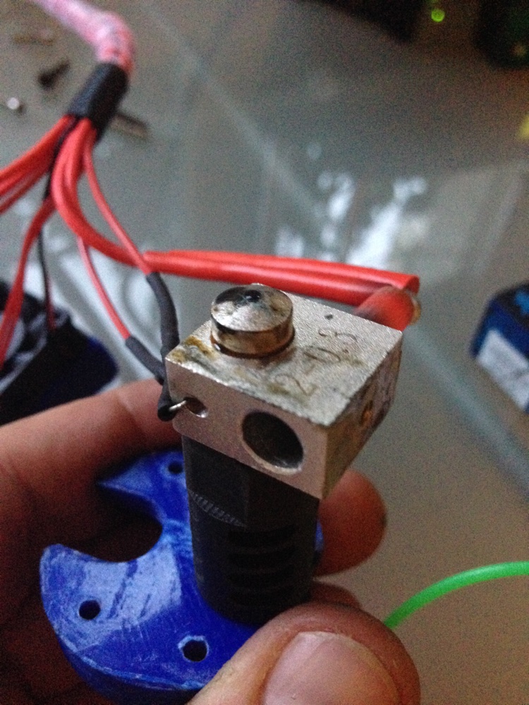

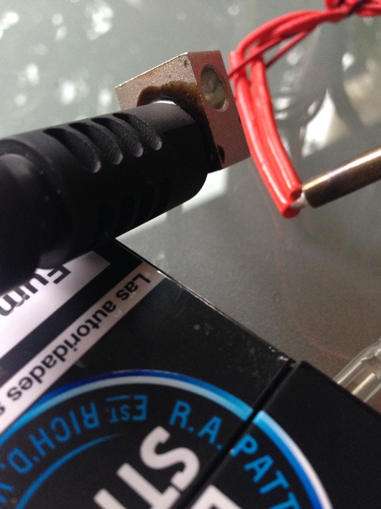

I have unmount the hotends to clean and extrude manually. Before unmount I have been watching the nozzles with 8X magnifying glass. I can't see the nozzle hole, It seems like the nozzle doesn't have hole. After unmount an take out a huge piece of melted PLA from the black part of the hotness I have mount again, heat the extruder to 220º and tried to push manually the filament into the hotend. As you can see in the attached pics the melted PLA gets out by the sides between nozzle and black plastic part,and I can assure that it was screw very tight. Please tell me what can I do.
- IMG_0539.jpg (277.42 KiB) Viewed 13860 times
- IMG_0538.jpg (184.89 KiB) Viewed 13860 times
- IMG_0537.jpg (206.78 KiB) Viewed 13860 times
